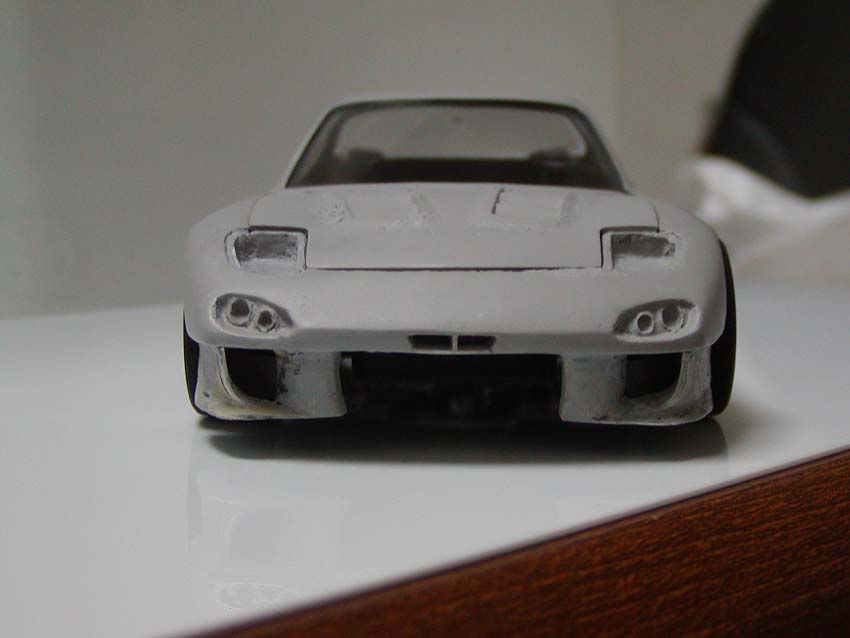

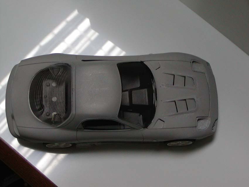

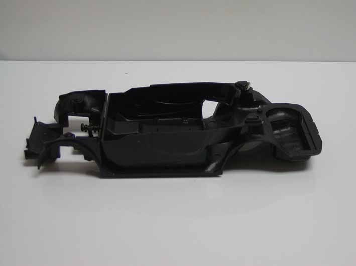

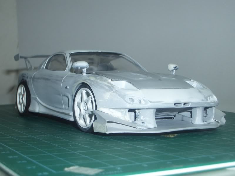

Hi everyone. Have been on this project for some time. The Amemiya RX7. Been building from tamiya RX7R1 base. Still very rough in its development stage. Hopefully could give advice to this newbie. Thks. Sorry abt the big attachment. Do not know how to edit these photo.
http://i71.photobucket.com/albums/i134/rainterlude/amemiya%20rx7/P1010416.jpg
http://i71.photobucket.com/albums/i134/rainterlude/amemiya%20rx7/P1010418.jpg
http://i71.photobucket.com/albums/i134/rainterlude/amemiya%20rx7/P1010420.jpg
D_LaMz
05-22-2006, 10:53 PM
looking good so far!

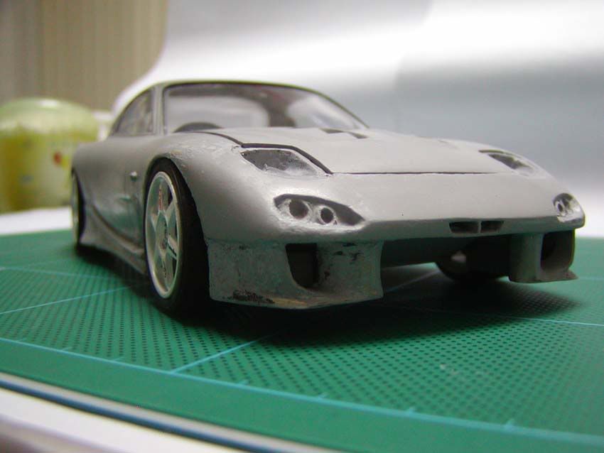

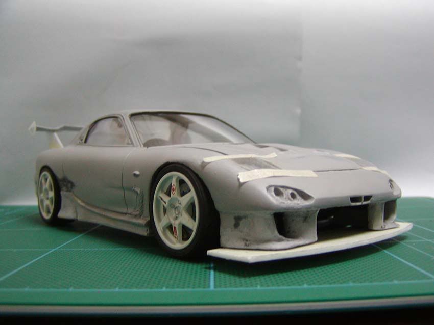

http://i71.photobucket.com/albums/i134/rainterlude/amemiya%20rx7/P1010428.jpg
Have primed the body & done up the headlights. Realise that the surface, especially at area which are puttied and sanded are not as smooth as expected. Area are filled with pit holes. How am I going to make it as smooth as the rest of the body? being using tamiya basic putty as the top coat.

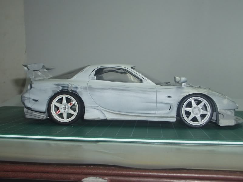

http://i71.photobucket.com/albums/i134/rainterlude/amemiya%20rx7/P1010427.jpg
Another pic

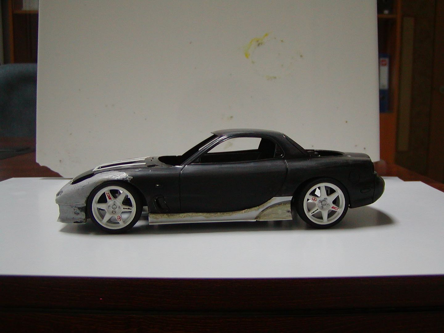

http://i71.photobucket.com/albums/i134/rainterlude/amemiya%20rx7/P1010436.jpg
have sand the headlight section & redone the air inlet area(should look more proportional now) hood section is almost done up, less for a bit of sanding touch-up.

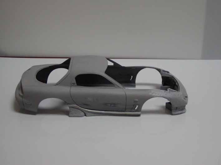

http://i71.photobucket.com/albums/i134/rainterlude/amemiya%20rx7/P1010439.jpg

Just a little progress. This modification is draining me quite a bit. :disappoin One thing I cannot get it right is the putty work.
After applying the tamiya basic putty, have to sand from grade 600 to 1000 sandpaper.
The result is a lot of pit hole at the area. :banghead:
Can anyone give any advice?:crying:

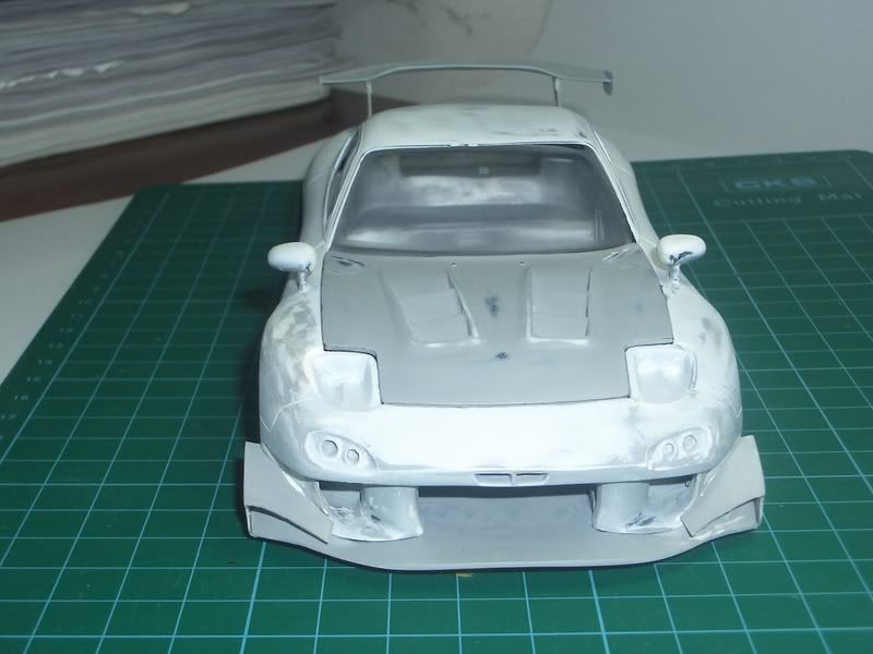

http://i71.photobucket.com/albums/i134/rainterlude/amemiya%20rx7/P1010479.jpg
This is what i been refering above. Could not get it to be as smooth as i want.
http://i71.photobucket.com/albums/i134/rainterlude/amemiya%20rx7/P1010467.jpg

WRC_413X
06-23-2006, 07:58 PM
Yep its a lot of sanding and a bunch of time :lol: but it can pay off. You're work is coming out nicely, the hood looks great, almost like it was just a factory part with just a coat of primer on it.
I might recomend after you get all your putty work really looking good and sanded best you can with basic to let it air out for a little while to allow it to really dry and then hit it with a good coat of a good building primer and then wet sand that nice n smooth.That should fill in the little pin holes. Then with a coat of sealer like zinser bin to help well...seal it and help prevent as much shrinking as you can, before applieing paint.
BTW IMO for some of your next serious scratchbuilding projects id try to steer clear from the basic and other 1 part putties. because they tend to shrink a lot and that not only can affect paint but you cant put a lot on at a time you have to do a hundred little spots and layers,(as im sure you know :shakehead ) So try and do big work and scratch stuff with some types of two parts i.e. polyester and epoxy putty. you can hit up the great how to on this by GTmike400 http://www.automotiveforums.com/vbulletin/showthread.php?t=540133
Keep on sanding and keep up the great work! :)

efunk
06-26-2006, 12:27 PM
:grinyes: Thank you WRC_413X & nugundam93 for the advices. Appreciate it a lot.
I was using a industrial based poly putty for the some of the beginning work.
The modificated front end of the body is mainly done with it. But I realize
that I could not get a very smooth surface with it.
Thus the basic putty(tamiya) was used to smoothened it out by spreading it out over the area affect.
From what i read, the one part putty will affect the paint job. :banghead: I have some quries in mind.
1) Could i apply tamiya epoxy putty over the area where basic putty was initially used?
2) How long do I have to air the basic putty? & do I immediately apply the sealer after applying it.
3) what is the industrial name for the sealer?
(believe that most hobby shop do not stock them. may have to try my luck at the DIY shop).

WRC_413X
06-28-2006, 06:43 PM
Thanks,
1-Applying the epoxy putty over the tamiya basic and that other putty should be no problem because it will create its own hardened shell and it should prevent anything underneith it from shrinking . I wouldnt put the epoxy putty over everyplace that you have the basic especially if it is about finished and smooth because it will make it larger and mess up the scale. probably just on the areas that are still rough or unfinished.
2- As far as airing goes id let it "fully" dry for about 2-3 days, then if you have to do any sanding before sealing it. you want to have all your bodywork don before putting a coat of sealer on it because the next step will be priming and painting.
3-A fairly popular sealer that is available is called Zinser bin its available at most places like home depot, but being in singapore im not sure what kindof places you have available. id suggest looking around at some local diy stores like you said or even finding some fellow singapore modelers on af for more specific advice. And then theres the internet...lol
good luck its coming out good so far!
