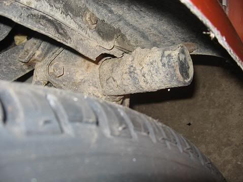

To verify the year, check the VIN on the title. If it starts "118" it's a '68. "119" is a '69.
Another way to tell is to look at the torsion bar caps, right in front of the rear wheels. If it's a flush cap, without the tortion bar sticking out, it's a swing axle rear....1968 (or earlier). If the tube sticks out through the cap, it's a IRS rear ....1969 (or later).

Im guessing this is the '69 by your description...
You guys have been great help and I really do appreciate it!
http://img.photobucket.com/albums/v343/adjacent/4e7aa742.jpg
