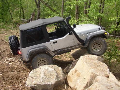

I run 3.75" BS. I wouldn't even consider going more than 4" max.
A few pics of my Jeep. I have 33x12.5x15" BFG MT KMs on 15x8 wheels with 3.75" BS. (I also have 6" Warn Flares.)

3.75" BS on the wheels and say 31x10.5x15 tires and he is going to have his tries sticking out about 1/2" on each side.
Ray H
05-15-2006, 04:57 PM
Itll be a little more than that. My wifes TJ has 4.5" BS on 8" wheels with 31X10.50s. The tread stuck out about .75" with Sport flares. I had to put Sahara flares on to pass inspection.
With 3.75" BS and 10.50" tires, they would probably stick out more like 1.5" past the flares.
It probably doesnt matter in NM but WV are pricks when it comes to the yearly inspection. In NM its probably just about personal preference. Personally, I like to keep the tread under the flare so it doesnt kick water up the side and onto the driver.
