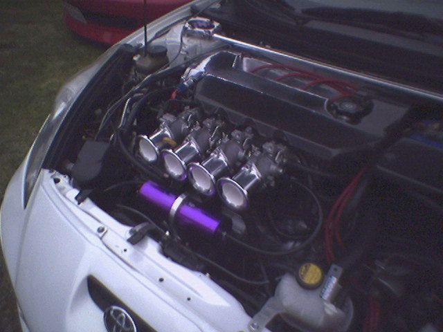

It can be done, it's just that on the celica the ITB's would hit the hood. You would have to get an aftermarket hood to do it.
I don't remember this girl having a weird hood. But maybe I forgot. But yea this girl fitted her Celica with ITBs. http://i7.photobucket.com/albums/y265/SigmaProjects/Car%20stuff/7thgenwithITB.jpg

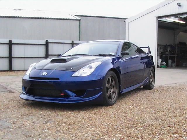

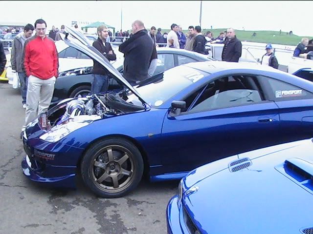

Actually there is a 7th gen celica running 10's.
http://digits.smugmug.com/photos/72416833-L.jpg
http://digits.smugmug.com/photos/72416892-L.jpg
http://digits.smugmug.com/photos/72416930-L.jpg
http://digits.smugmug.com/photos/72417999-L.jpg
http://i2.photobucket.com/albums/y11/bazzagt4/PIC_0024.jpg
http://i2.photobucket.com/albums/y11/bazzagt4/PIC_0019.jpg
http://i2.photobucket.com/albums/y11/bazzagt4/nettyssantapod009.jpg
http://i2.photobucket.com/albums/y11/bazzagt4/PIC_0013.jpg
Spec apparently is..
Engine: ST205 3sgte, 2100cc, 650ish bhp. HKS Stroker Crankshaft Crower Rods JE custom pistons ARP bolts HKS camshafts HKS cam pulleys Ferrea Valvetrain Dual valve spring conversion. Fensport Racing cylinder head. Fensport racing intake manifold. Turbocharger System: Garrett GT3542 Ball bearing, watercooled HKS stainless tubular manifold Tial 44mm racing wastegate 90mm Exhaust system. Titanium rear silencer. Transmission: Fensport Racing triple plate clutch. Fensport Racing 5 speed H pattern, Dog engagement, Straight cut gearbox. Fensport Racing front LSD plate type. Cusco Rear LSD plate type. GT4 driveshafts. Cooling systems. Aluminium double row Radiator. Swirl pot and Header tank. HKS Supra intercooler. Exact Oil cooler. Exact Fuel Cooler. ERL water injection Suspension: Tein Flex coilovers. Superflex Poly bushes. Adjustable camber front and rear. Carbon strut bracing. Brakes: Tarox 330mm vented disc with alloy bell and 10 pot calliper. Rear 270x10 solid disc with 6 pot calliper. Fuel system HKS 1000cc injectors HKS fuel rail. HKS adjustable pressure regulator. Aeromotive High capacity fuel pump. Aeromotive pressure regulator Holley Lift pump Swirl pot. -10 Stainless braided fuel lines. Electronics: Custom wiring loom. Motec M4 professional ecu Lambda control Data logging Boost control Launch control Full throttle gearshift Motec Sport dashboard. Exterior: Carbon Bonnet with custom vent Carbon Tailgate GT type front bumper and C-one spoiler. TRD Rear wing Polycarbonate rear window. GT Rear lights. Wheels: Rays TE37 Tyres:TOYO R888 - Road Legal
11 sec quarters on its first runs when the car was only 3 days old
a week later it went 10.63 @ 134mph

Does the ITB help the celica a lot more then just having a cold air intake?
yes, think the stock 4afe TB is only 42mm, what if you had 4 38 mm throttle bodies? they flow alot better
And with the ITB you couldn't get forced induction could you?
you have 4 inlets instead of 1, you would have to route the charge pipes to all 4 openings and hope they are all recieveing the same amount of air, becuase if not you will run too rich/too lean
Where could I get some ITB's?
for what? usually you have to build your own, you could have somoene build them for you or find a used one thats already built....i love the sound of ITB's, and they add adecent amount of power
