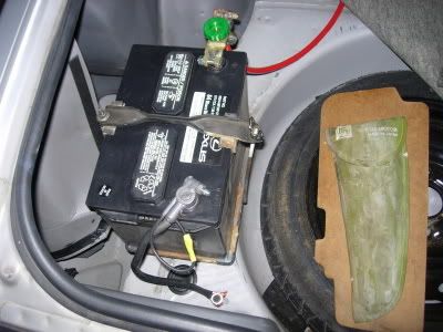

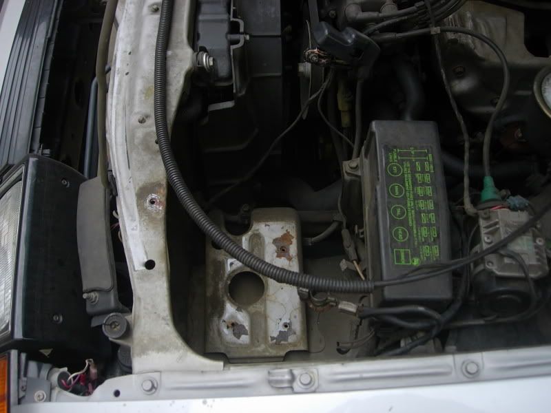

I liked how it felt when I did it to my last one, I'm sure I'll like the way it will feel this time:grinyes:
http://i7.photobucket.com/albums/y265/SigmaProjects/83%20Celica/DSCN1935.jpg
http://i7.photobucket.com/albums/y265/SigmaProjects/83%20Celica/DSCN1939.jpg

What is the purpose for relocating the battery? Do you have a problem with ventilation with the battery in the trunk?
SigmaProjects
05-09-2006, 05:04 AM
no, there's no problem with ventilation. Moving it to the back helps give a closer 50/50 weight ratio. The battery makes up almost 2% of the car's weight. Plus the battery stays much cleaner in the trunk =P

naw, I'm not that much of a noob to not do it myself, lol. I used about 14 feet of 4 guage cable, got the terminal switch for 3 bucks, reused the old battery plate, drilled holes and threaded them, used some marine goop, that sealer stuff for RVs, holds on to things like no other and doesn't allow water to get into exposed places, got a new ground cable from the junk yards (there are nice cables out there becuase people fix up their old cars and junk them, lol), and found another bar that holds down the battery strap so I had two of them to secure the battrey to the plate. Most expensive part is the cable, 4 gauge cost about 1.50 a foot here. I didn't think you could run the battery that well with 8 guage. My volt gauge reads just above 12, which actually seems better than before, lol. You should really get the RV glue stuff, they have it any hardware store, it turns to rubber practically and will never let go, lol. Great if you want the battery to stay put, but I used screws with it too just in case.

hmm.. I was just worried cuz of the distance, i mean 15 feet is a bit more than the regular 3 or 4 feet when it's in the engine bay.
