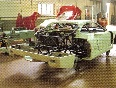

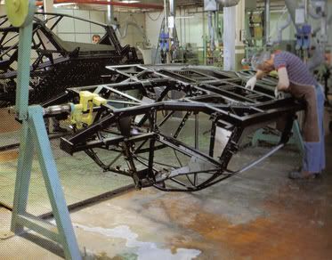

Her are some pics of the F40's structure during the production line and a break up of what was what material. I hope you find them useful, they have helped me in my 1/12 project as far as its gone any way.
http://i46.photobucket.com/albums/f122/cfcrules/Ferrari%20F40/f40.jpg
http://i46.photobucket.com/albums/f122/cfcrules/Ferrari%20F40/r401.jpg
http://i46.photobucket.com/albums/f122/cfcrules/Ferrari%20F40/f402.jpg

Woooooow. That's what I need, Ales. What a collection of pics.
Thank you very very very very... much.
Cheers!
