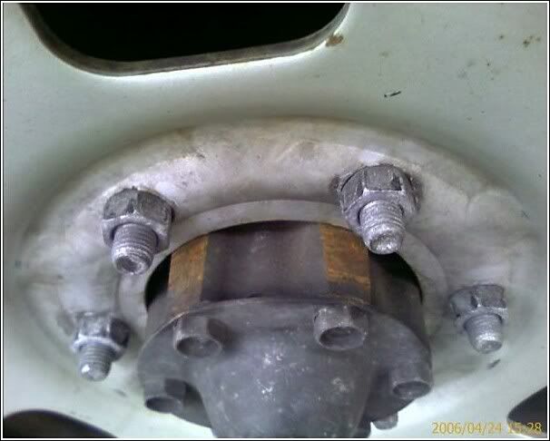

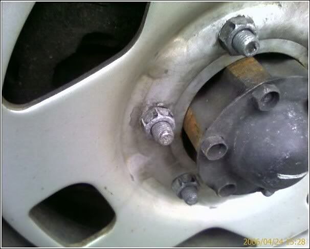

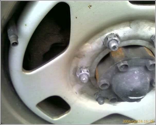

ok so here's the thing i take my truck into pepboys for a tire rotation and below is the end result...what doesnt look right to you guys ? i saw it instantly and was told "your claim is not valid with me sir"

are those even lug nuts?
Are the bolts stripped?
they are now!!!
did you notice the depth at which the nuts were tightened?(not to mention they arent even the correct nuts for the truck)
they are now!!!

Ahh, yep, there nice and stripped for ya. Don't ya hate that?

I had the local mechanic strip the bolts on my '95. They were a $1-$3 at Auto Zone. The lug nuts are more and considered special. They don't come up on a Isuzu search at the parts store.

i got a call from the district manager and i am meeting with him and another store manager tomorrow to get this resolved...not only did they damage the lugs they damaged the rim by putting them on like such...and this is rim number 2...for those true rodeo enthusiasts you can clearly see those arent the proper lugnuts for the truck...but thats what they installed back when they broke off the original studds because the technician was a de de deee(carlos mencia reference)...lets just say he wears a bib and wasnt even at a red lobster

The anti seize on the lugs and studs makes it difficult to tell, but they undoubtedly buried the nuts into the wheels. I'd never allow anyone to install wheels with an impact wrench set to more than 50 ft/lb. Almost all current vehicles have a specification for wheel lug torque, and almost no one at these places understands or respects that fact. The "torque sticks" that they use to "limit torque" from impact wrenches just don't work like they should. If someone were to walk toward me with one of those as a "tool", he'd probably end up walking away, bow-legged, with a new "implant" and no tool...
Lug torque is important not only for security, but to assure that rotors and hubs are not warped, and alloy wheels are not distorted.
You now have a little work to do - Or pay for.
