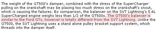

http://img.photobucket.com/albums/v521/65ShelbyClone/Untitled-1copy.jpg
From the paragraph before that
Ford designed a crankshaft damper specifically for the GT500
The one that was on the GT was less than half the weight as the one on the GT500 and was specifically designed for GT.
speedfreak
04-24-2006, 01:44 AM
Ok, it doesn't say that anywhere.
01L2Cobra
04-24-2006, 08:53 AM
Its in the 2nd paragraph in the link I posted
speedfreak
04-24-2006, 02:34 PM
Sources close to the 2007 Shelby GT500 program are alleging that the crankshafts in the 5.4L GT500 engines are fracturing or breaking at the snout (nose) where the engine damper rides. The sources are alleging that the GT500 crankshaft breakage can be attributed to two complimentary issues. According to our reliable sources, Ford designed a crankshaft damper specifically for the GT500, but the damper weighs in at a hefty 26 pounds.
This is the second paragraph and it says nothing about the GT's damper nor how much it weighs. It just says that the GT500 got a damper designed just for it. That could mean anything, like its almost identical to the GT's, but the diameter is different or the pully configuration is changed, but they weigh the same. I'm done with this, it doesn't even matter at this point other than crank failures shouldn't have been a problem.
