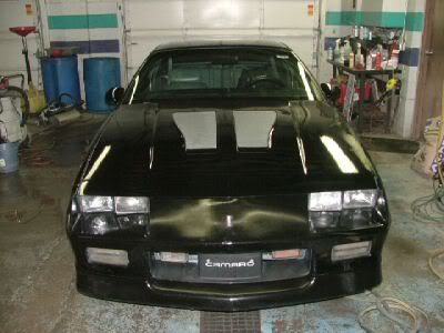

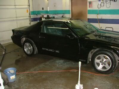

btw, this is carrie. pride, joy, and stress.

Nice looking car, btw.. funny my 3rd gen is my pride, joy, and stress too.

thanks man. shes a bitch to keep clean even garage kept but.. worth it of course.

Nice car tho, i see someone else pulled the same as my cars previous owner and painted black over the turqoise blue :lol: Keep ALOT of polish on the bumpers, the paint starts to peel really quick off of them. :thumbsup:

lol. cant seem to hide that blue. and yur not lyin abou the paint peeling on the back, already happening. im gunna take it down to the primer and go black again eventually cause he didn't get the greatest job on it. Im gunna replace the relay, flush the radiator, and probably get a new cap just in case. Nothing wrong with having some new parts I guess. But I feel a lot better about it now, I had no idea they ran that hot. I appreciate the help.
