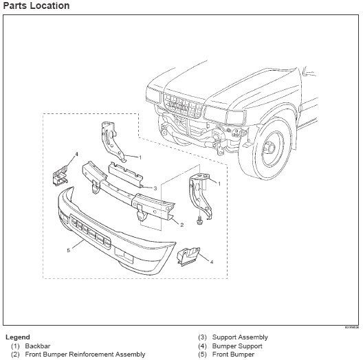

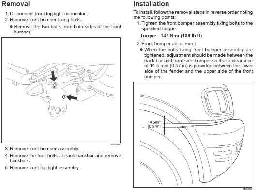

Hello Everyone,
I am trying to install the ARB Bumper for my 2000 Rodeo but I can't seem to get the stock front bumper off. Can someone please tell me how many Bolts need to come off and the area where they are located? If someone could take pictures of the locations that would be very helpful. I was under the rodeo for over an hour and couldn't get the bumper off. All I took off was the little screws holding the shell. The large bolts won't budge and all and it started to strip the bolt a little so I stop. I don't even know if I was hitting the right ones...PLEASE HELP ASAP. TIA!

Maybe these will help. You dont need to take off the cover to take the bumper off.http://i30.photobucket.com/albums/c337/Gizmo420/bumper2.jpg
http://i30.photobucket.com/albums/c337/Gizmo420/bumper1.jpg
