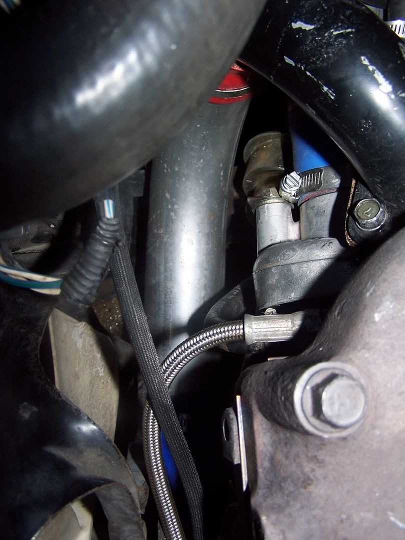

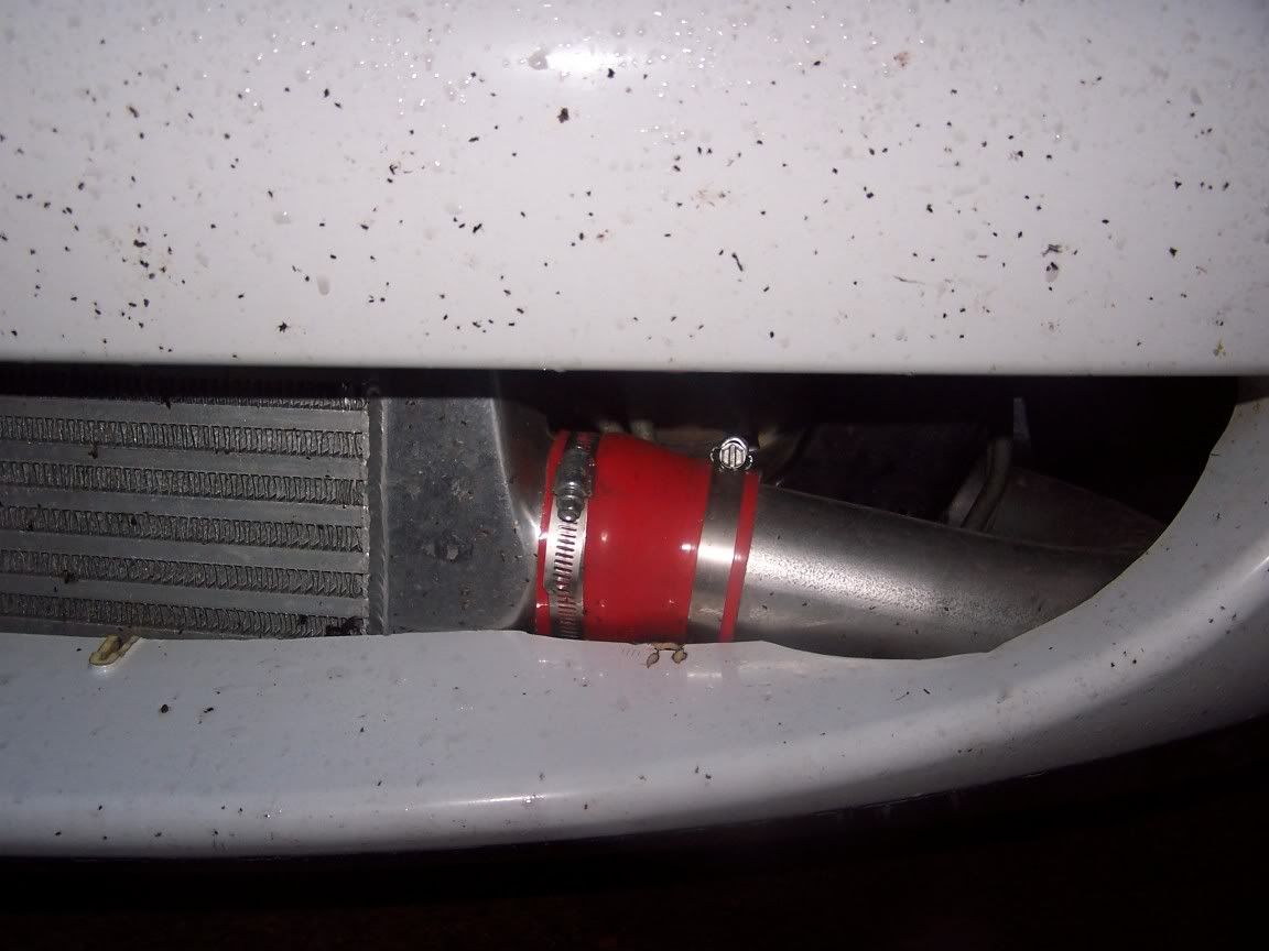

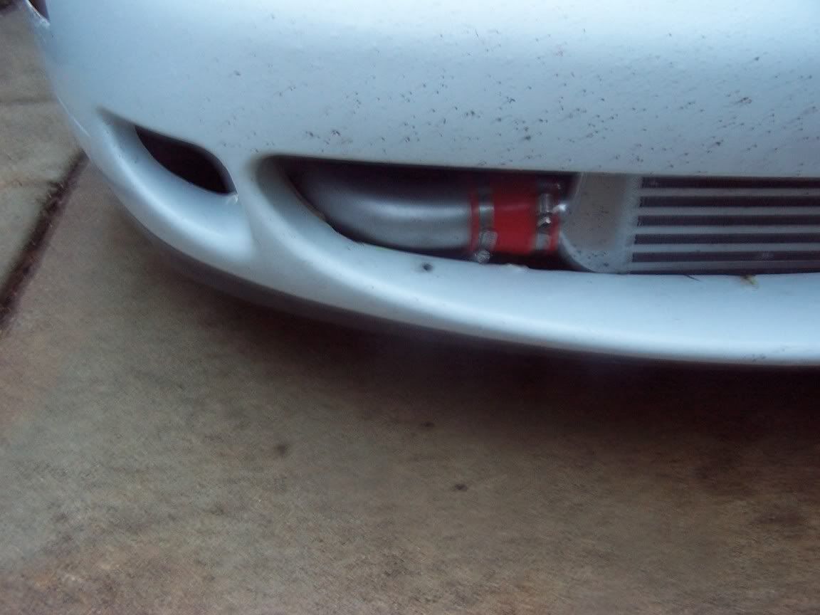

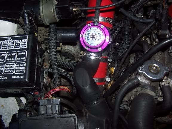

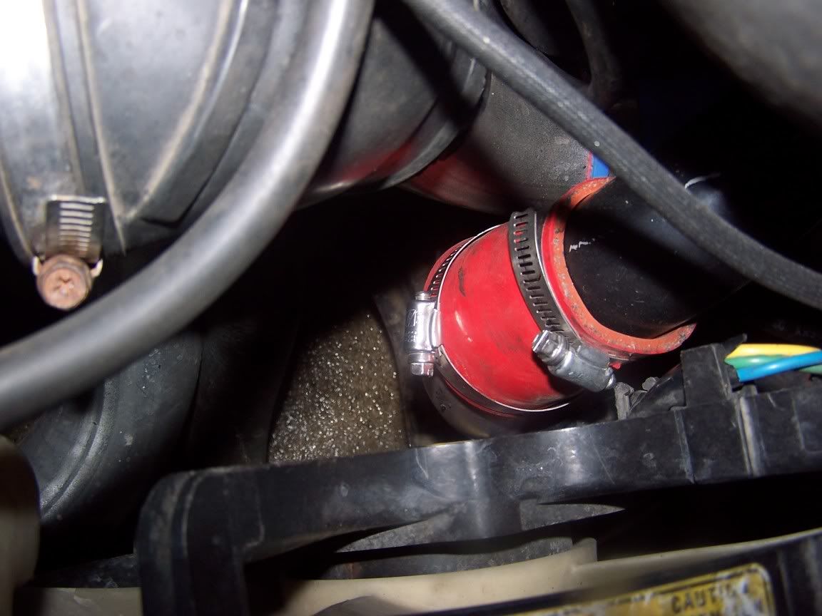

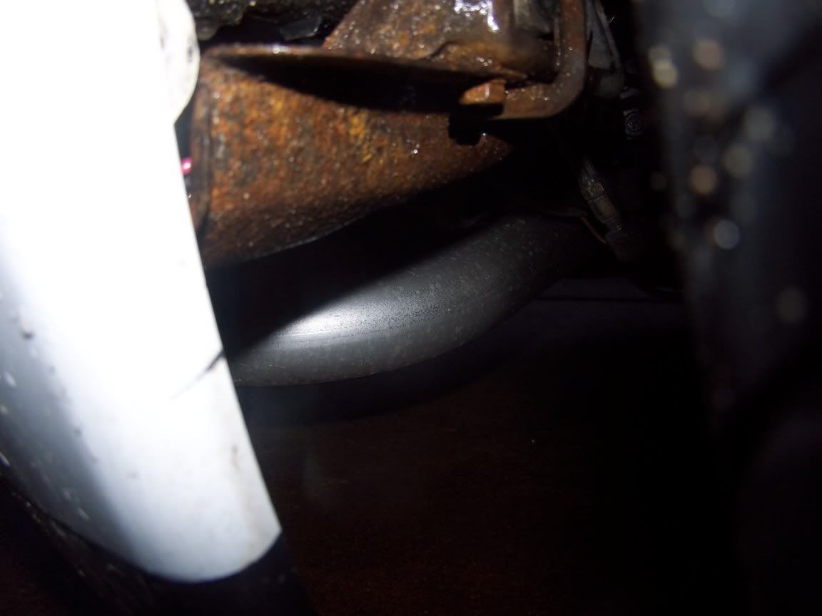

ebay core pipes from summit and a bov flange from ebay. Total was less than $300 actually it was around $200-$250 Here are some pics
http://i35.photobucket.com/albums/d161/BoosTSi/100_4478.jpg
Bov flange and 90* to tb
http://i35.photobucket.com/albums/d161/BoosTSi/100_4477.jpg
off the j-pipe around the rad to the left side of the ic

http://i35.photobucket.com/albums/d161/BoosTSi/100_4475.jpg
This is a u-bend that I cut short on one side and it connects directly to the pipe coming off the the jpipe
http://i35.photobucket.com/albums/d161/BoosTSi/100_4474.jpg
behind the bumper on the left side

http://i35.photobucket.com/albums/d161/BoosTSi/100_4472.jpg behind the bumper on the right side. Its another u-bend that goes from the ic to a 45* up to the tb

http://i35.photobucket.com/albums/d161/BoosTSi/100_4470.jpg
under the intake
http://i35.photobucket.com/albums/d161/BoosTSi/100_4469.jpg
bov and 90*

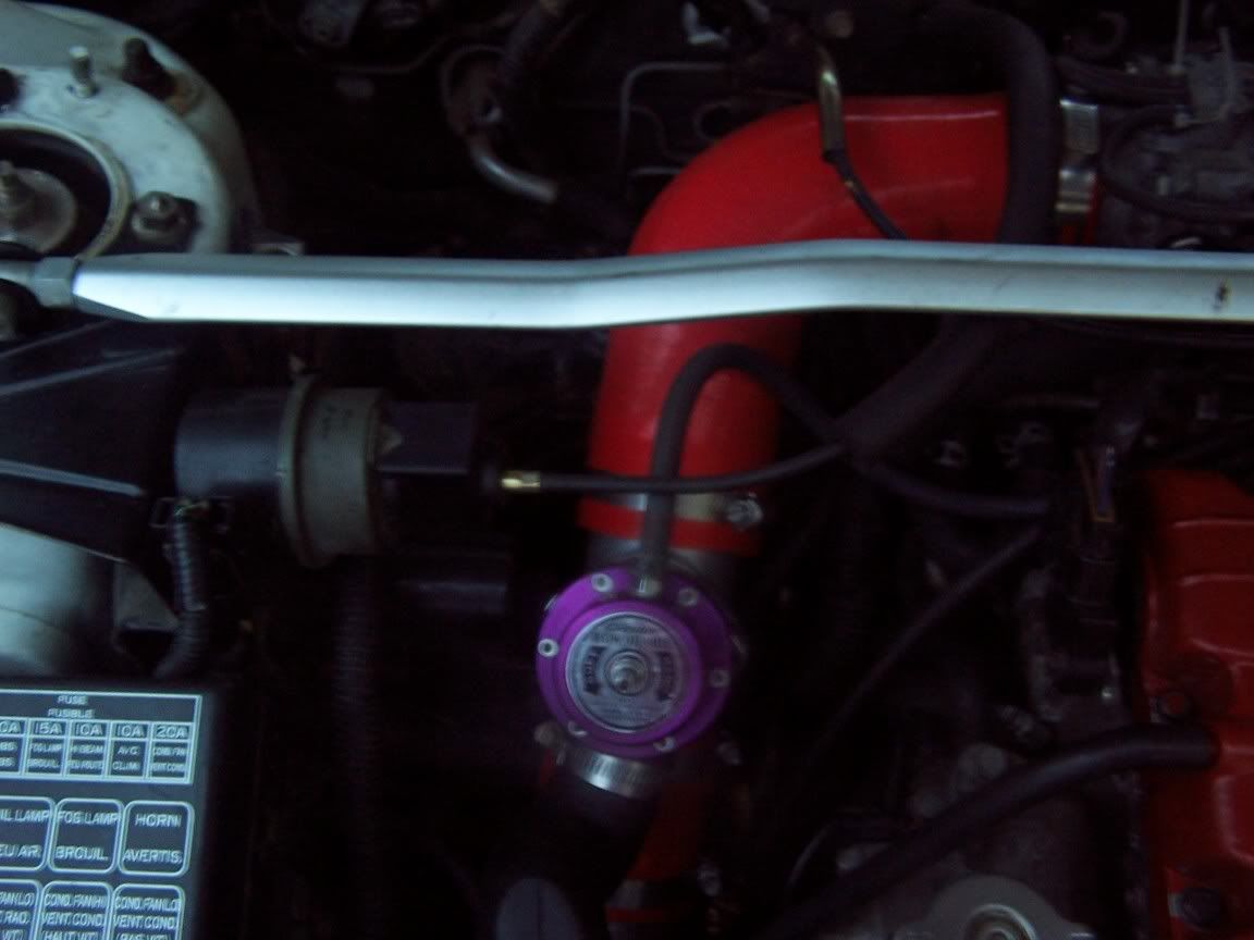

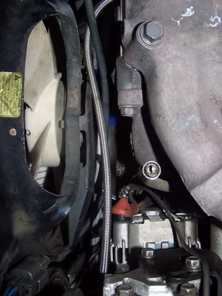

bov and 90*
I hope this helps. If anyone needs anything else let me know

Thanx alot man nice pics. That should help me a little with my own fabrication. The kits are crazy on price. I have spent a shit load of money so far, so every cent saved helps big time!!!! By the way where did you get you oil braided line from? I need the braided line only, because i made my own J-Pipe and flange, it came out sweet!!!

that line came with the car so I couldnt tell you. I have a 1g hard oil feed line if you are interested though

bah where you get that J pipe. I am sure cooling would be bette with slim fans =) it wont look as crowded either, but awesome pics.
