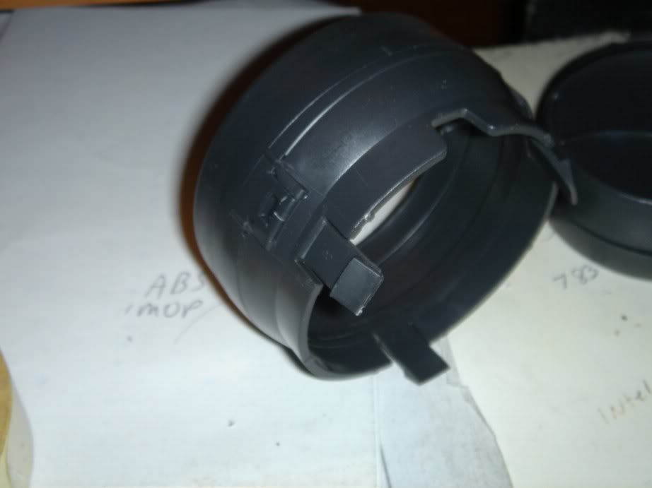

How do you take out the five air vents on a 2001 GA SE, i dont wanna brake them ive tryed prying them out pulling them and they wont come out, and im not gonna pay $$$$ to get new ones there prolly expensive so if anyone knows how lemme know....THANKS
You are lucky! I still hav some pics of those vents.
Use a coat hanger, bend a hook on one end(this is what you'll use to unclip them) and use a flashlight to look inside.
You will see three(3) tabs holding them in. Reach in unclip and gently pull on the vents outer part to keep them from recliping. Kinda tricky! Heres the pics, they should help you out.
