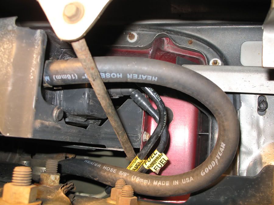

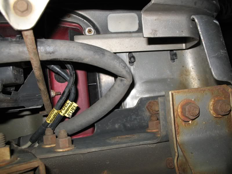

In my search for a cause of fuel related troubleshooting....I noticed that the rubber hose (which is labeled "AIR" on the box) running from the EVAP box, is kinked. I have a pretty good kink, that would definately cause restriction.
This hose is about 1" in diameter......seperate from the two other lines labeled as fuel lines.......

Here's the BEFORE:
http://i16.photobucket.com/albums/b40/JoshB_/IMG_0418.jpg
and the AFTER:
http://i16.photobucket.com/albums/b40/JoshB_/IMG_0419.jpg
gmtech79
04-10-2006, 07:00 PM
looks like someone either patched or relocated your vent valve

JoshBarber
04-10-2006, 09:28 PM
what do you mean? somethings different on mine?

gmtech79
04-11-2006, 07:55 PM
Yes, that is not the factory hose. It is originally a plastic hose like your fuel lines and those other evap lines are. Where is your vent valve at now?
JoshBarber
04-11-2006, 08:30 PM
take a picture of yours, cuz Im not following
