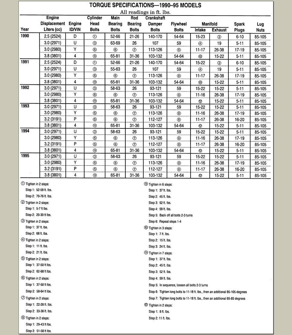

Hello was wondering if anyone knew where to get a online pdf for the 1993 Ford Taurus, that have the torque specs in it, any help appriciated

I have the '93 Taurus service manual on CD-ROM. If your list of needed torque specs is short, I can send the values your way.
Or, for $25 for the first year, you can subscribe to AlldataDIY and get access online to the complete factory service manual for a car (www.alldatadiy.com).

http://img.photobucket.com/albums/v11/Cajunblu/90-95TorqueSpecs.jpg
Hope this helps...
