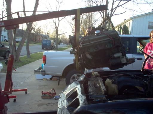

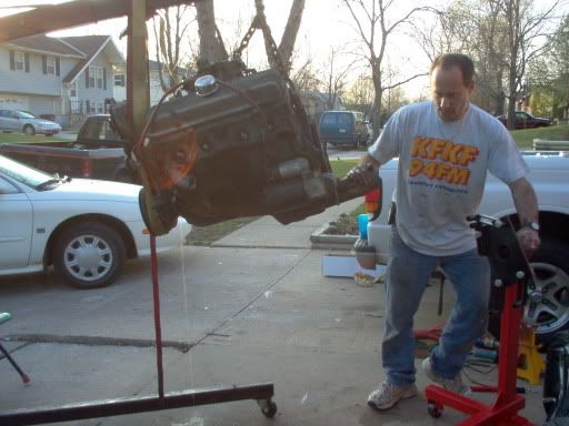

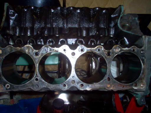

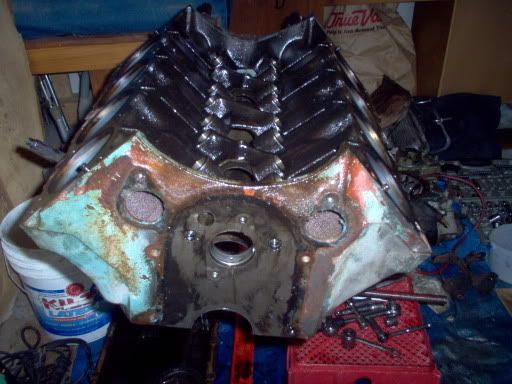

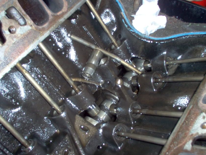

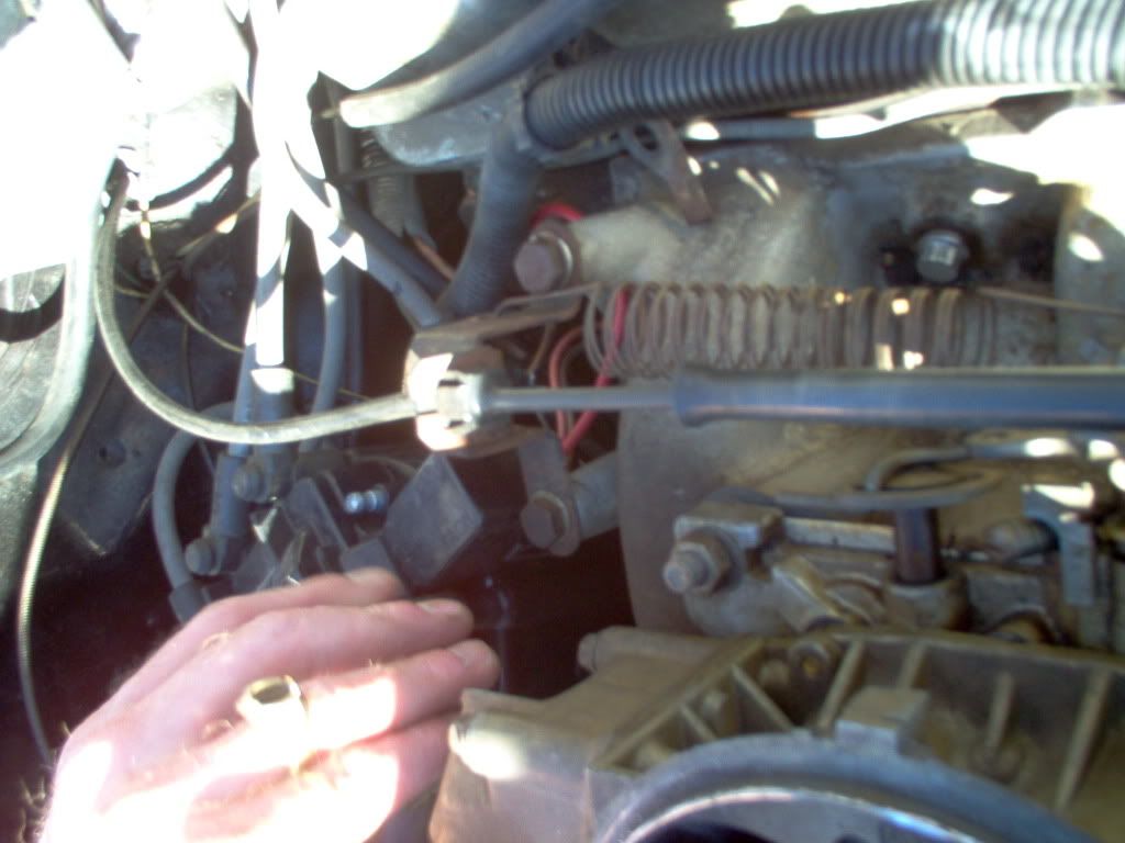

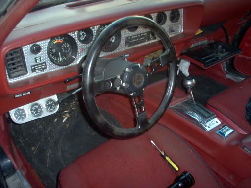

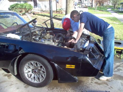

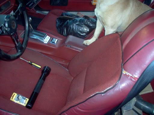

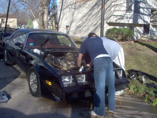

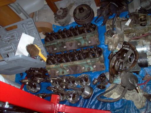

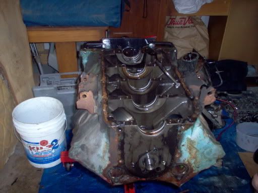

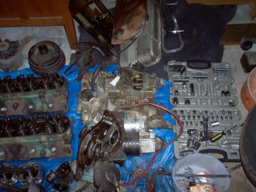

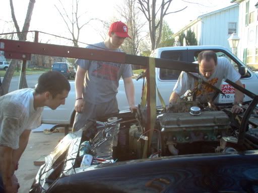

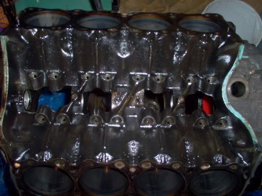

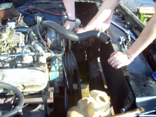

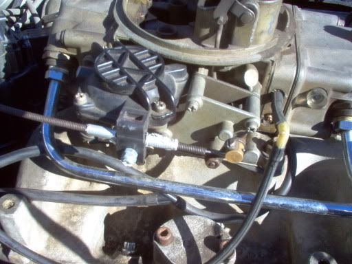

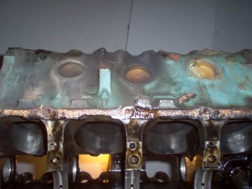

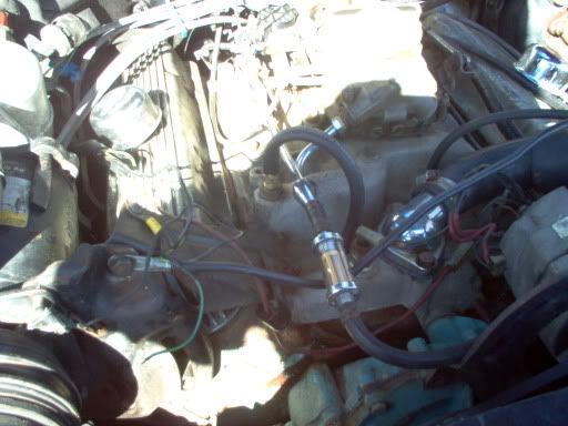

Welp here are some pictures of the progress....
http://img.photobucket.com/albums/v201/jordan11/enginepull001.jpg
http://img.photobucket.com/albums/v201/jordan11/enginepull002.jpg
http://img.photobucket.com/albums/v201/jordan11/enginepull003.jpg
http://img.photobucket.com/albums/v201/jordan11/enginepull004.jpg
http://img.photobucket.com/albums/v201/jordan11/enginepull005.jpg
http://img.photobucket.com/albums/v201/jordan11/enginepull006.jpg
http://img.photobucket.com/albums/v201/jordan11/enginepull007.jpg
http://img.photobucket.com/albums/v201/jordan11/enginepull008.jpg
http://img.photobucket.com/albums/v201/jordan11/enginepull009.jpg
http://img.photobucket.com/albums/v201/jordan11/enginepull010.jpg
http://img.photobucket.com/albums/v201/jordan11/enginepull011.jpg
http://img.photobucket.com/albums/v201/jordan11/enginepull012.jpg
http://img.photobucket.com/albums/v201/jordan11/enginepull013.jpg
http://img.photobucket.com/albums/v201/jordan11/enginepull014.jpg
http://img.photobucket.com/albums/v201/jordan11/enginepull015.jpg
http://img.photobucket.com/albums/v201/jordan11/enginepull016.jpg
http://img.photobucket.com/albums/v201/jordan11/enginepull017.jpg
http://img.photobucket.com/albums/v201/jordan11/enginepull018.jpg
http://img.photobucket.com/albums/v201/jordan11/enginepull019.jpg
http://img.photobucket.com/albums/v201/jordan11/enginepull020.jpg
http://img.photobucket.com/albums/v201/jordan11/enginepull021.jpg
http://img.photobucket.com/albums/v201/jordan11/enginepull022.jpg
http://img.photobucket.com/albums/v201/jordan11/enginepull023.jpg
http://img.photobucket.com/albums/v201/jordan11/enginepull024.jpg
http://img.photobucket.com/albums/v201/jordan11/enginepull025.jpg
http://img.photobucket.com/albums/v201/jordan11/enginepull026.jpg
http://img.photobucket.com/albums/v201/jordan11/enginepull027.jpg
http://img.photobucket.com/albums/v201/jordan11/enginepull028.jpg
http://img.photobucket.com/albums/v201/jordan11/enginepull029.jpg
http://img.photobucket.com/albums/v201/jordan11/enginepull030.jpg
if you waited for all those to finish you have a lot of free time ... lol

ouch, nasty push rod, but it looks like it's goin good so far, that thing's gonna be a damn beast when it's done, make the second generation proud :)

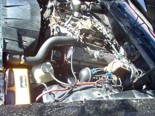

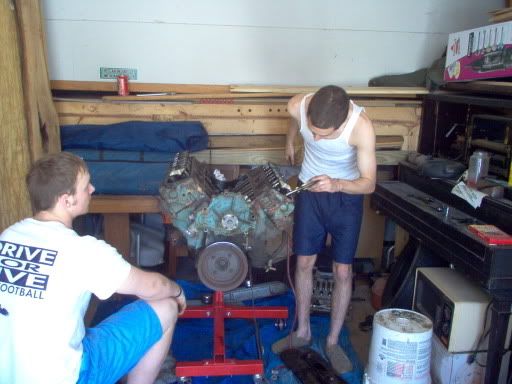

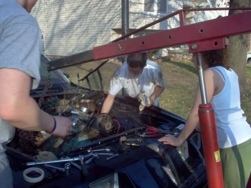

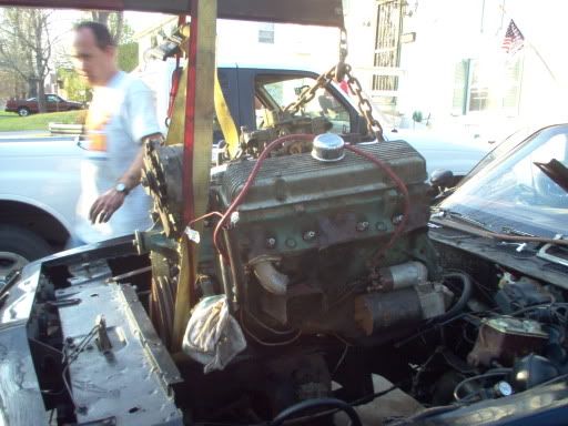

welp here is what has been done on day 2
http://img.photobucket.com/albums/v201/jordan11/Engine%20Pull/enginepulld2001.jpg
http://img.photobucket.com/albums/v201/jordan11/Engine%20Pull/enginepulld2002.jpg
http://img.photobucket.com/albums/v201/jordan11/Engine%20Pull/enginepulld2003.jpg
http://img.photobucket.com/albums/v201/jordan11/Engine%20Pull/enginepulld2004.jpg
http://img.photobucket.com/albums/v201/jordan11/Engine%20Pull/enginepulld2005.jpg
http://img.photobucket.com/albums/v201/jordan11/Engine%20Pull/enginepulld2006.jpg
http://img.photobucket.com/albums/v201/jordan11/Engine%20Pull/enginepulld2007.jpg
http://img.photobucket.com/albums/v201/jordan11/Engine%20Pull/enginepulld2008.jpg
tommorow after school i plan on taking the block to get hot tanked, bead blast, new freezer plugs, bored over and checked for cracks and defects wich will cost me a whole whopping 150$ wich is really good if you ask me.
