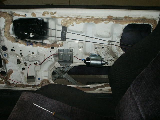

1PhatCX
03-28-2006, 07:24 PM
tell them the spot right where the arm rest on the door is the best spot, the solenoid will sit nicely in there and will work fine
thats where i had mine mounted

1PhatCX
03-29-2006, 06:19 AM
yea we drilled holes in the door and bolted the mounting bracket to the door, i'll see if i have a pic
1PhatCX
03-29-2006, 06:27 AM
only pic i could find
http://i15.photobucket.com/albums/a400/1PhatCX/poppers.jpg
YZ125rider21
03-29-2006, 06:53 PM
hey the poopers wear out fast in that spot...cause thats a spot i told them to mount and they all said they cant cause door panel be in way...i going back down there with this pic lol....gonna let them have it!!!!!!!!!1
1PhatCX
03-29-2006, 07:24 PM
yea, it sits right in the arm rest, it works fine
