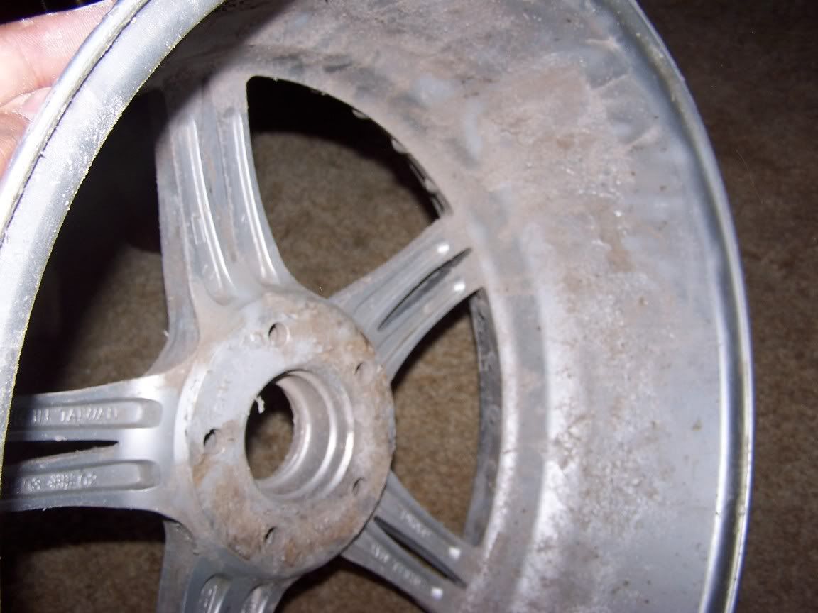

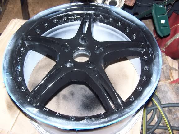

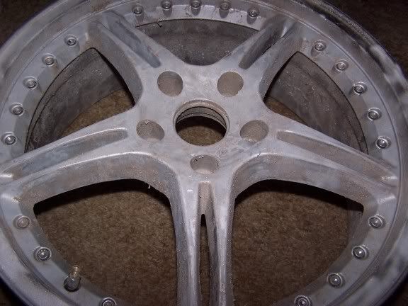

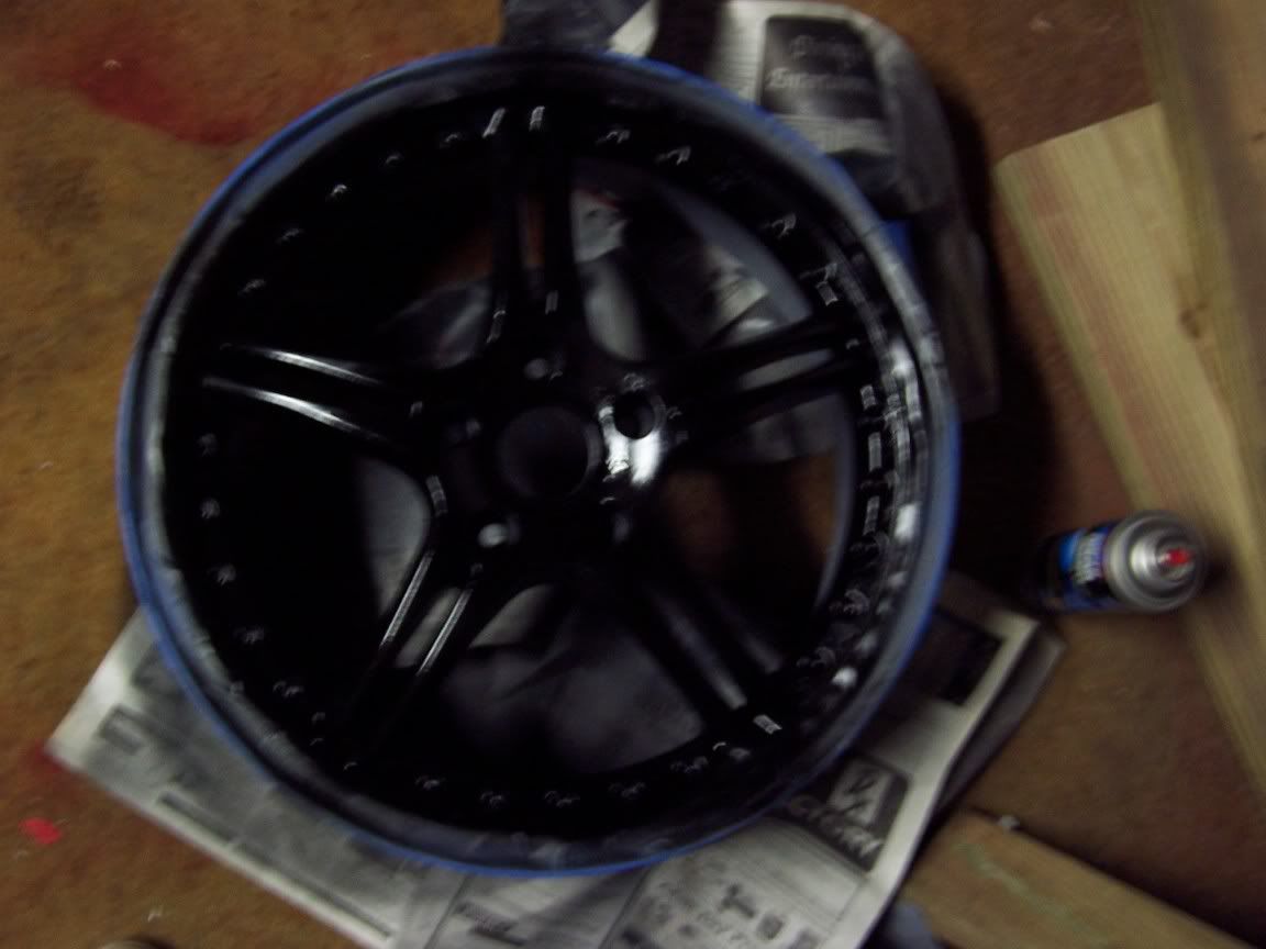

As promised here are some pictures and descriptions of how I did it.
Started off like this
http://i35.photobucket.com/albums/d161/BoosTSi/rims.jpg
Then I sprayed them down with some "sircraft coating remover"(extremely harsh stuff, will eat anything and everything off of the metal including your hands) then after scraping, sanding and sandblasting the looked like this
http://i35.photobucket.com/albums/d161/BoosTSi/100_4449.jpg
http://i35.photobucket.com/albums/d161/BoosTSi/100_4448.jpg
Then I spent 2 hours a rim sanding them smooth and then I put the first coats of primer and paint on today
http://i35.photobucket.com/albums/d161/BoosTSi/100_4450.jpg
http://i35.photobucket.com/albums/d161/BoosTSi/100_4451.jpg
I still need to clear them and finish polishing up the lip and then I'll post the finished product on the car. I used dupli-color primer and black enamal spray paint and dulpli-color high gloss rim clear coat. What do you guys think?

You didn't even wait an hour!!! Looks good though. I'd like to see some pics after clearcoat without the tape.

sanding it, starting with 220 grit going all the way to 1500 and then polishing the crap out of it with mothers aluminum polish

they are exel dl-46's. I always though of exel as a cheap off brand of rims untill I did the math and my rims with cheap nankang tires cost $400 more than the comperable tenzo-r rims with bfg's so I guess there is something to be said about that

Thats cool. Lets just hope you dont scratch the paint on the spokes when sanding the lip. That would make you want to do this: :banghead:
vanilla gorilla
03-27-2006, 05:25 PM
Also, what about the inside part of the rim...like behind the spokes, are you going to paint that also or polish or what?
blk_srt
03-27-2006, 06:53 PM
I'm going to paint that mat black, I just dont have the paint yet:lol:
