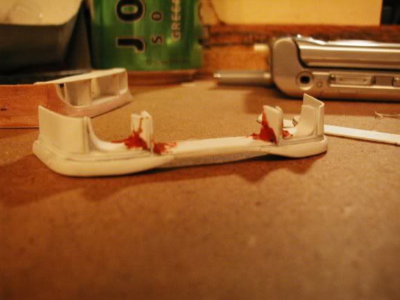

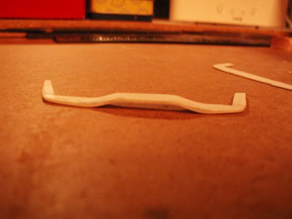

Here are some pics of what it looked like in the early stages (they go in order)
http://img.photobucket.com/albums/v281/SidewayzS15/BuildUp20.jpg
^^^^ Thats the lip I was talking about

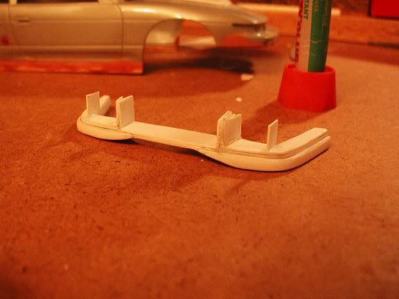

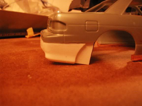

http://img.photobucket.com/albums/v281/SidewayzS15/BuildUp22.jpg
^^^^ Slowly added layers to level everything off, then put strips coming out to get an offset lip
http://img.photobucket.com/albums/v281/SidewayzS15/BuildUp25.jpg
^^^^ How I did my vertical supports

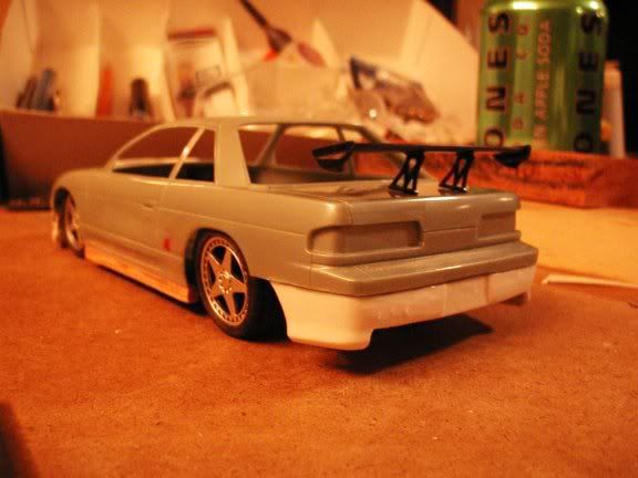

http://img.photobucket.com/albums/v281/SidewayzS15/FinishedOutdoors6.jpg
^^^^ Sand smooth, prime, paint, and you got yourself your very own custom bodykit

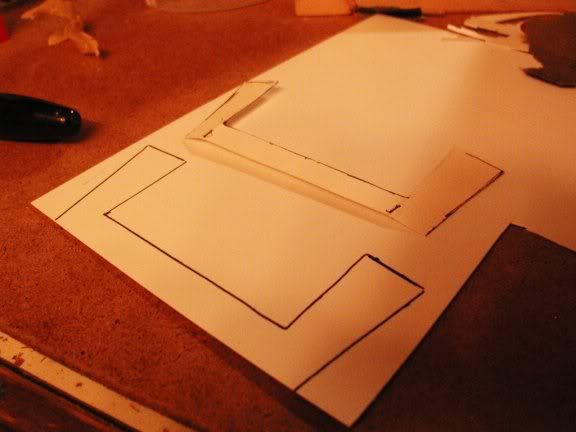

http://img.photobucket.com/albums/v281/SidewayzS15/BuildUp64.jpg
^^^^ I then made a template for the rear diffuser, this may take some time, but be patient with it

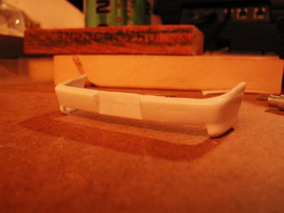

http://img.photobucket.com/albums/v281/SidewayzS15/BuildUp67.jpg
^^^^ Cut the diffuser out fro styrene and insert into the bumper, please note that I built up the bumper extensions to the wheel well, and that the rounded part is not from my template, that is a seperate piece.

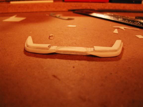

http://img.photobucket.com/albums/v281/SidewayzS15/BuildUp66.jpg
^^^^ To finish off the diffuser I then rounded a rectangle of styrene to fit in the diffuser, and made a notch for the exhaust.
Then just make sure its all solid, putty, sand, paint and you have your very own custom rear end!
