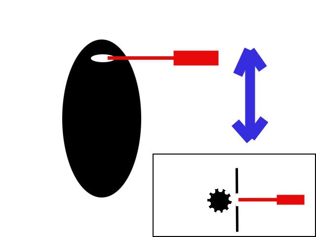

The auto tensioner mentioned above should be acceable though on the backing plate (the part behind the drum, and will be an oval slot, usually at the bottom. Insert a screw driver into the slot and turn the wheel, but one side is usually left hand thread and the other side is right hand thread, and you usually have to play with it for a while to figure out which is which. If this sounds confusing here is a little drawing that may somewhat help you.

http://img.photobucket.com/albums/v608/thesilentchamber/brakes/drum.jpg
