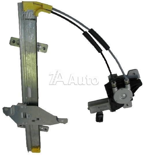

ok so my back passenger window decided to quit working a few days ago and today i managed to get the paneling and motor taken off, problem is i cant figure out how to remove the motor from the cables, is there tension inside it?? it looked like there was. i removed all the screws with a star driver but still couldnt figure out how to disattach it from the cables. should i leave it up to someone who knows how to do it or is it kind of easy? if anyone has any step by step directions or something that would be great. also how much is a new motor AND if i can have autozone or advance auto parts order me one by giving the year make and model? thanks!

That motor is not serviceable separately. It is part of the window regulator assembly (GM#10321731). The regulator assembly may be available aftermarket, but it doesnt appear that you can replace just the motor. The GM one isn't cheap, dealer cost is $193.12. They show a trade/installer price of $254.11, and a list of $338.81.

yeah now i see it, im at this site 1aauto.com and they list one for $99.95 (rear passenger) and i see how is all put together, this would be it right http://images.1aauto.com/WRG/1AWRG00177.jpg it looks pretty complicated to install though, whats involved? looks like the glass sits in that track of course.

Yep, that's the critter Mike. I haven't done one yet, so I'm not sure what's involved. If no one else chimes in today, I'll get my factory service manual out and see what is involved when I get home from work tonight.

Most people just change out the whole Bowden Cable regulator and motor assembly. This is the closest and most detailed procedure I have for doing that. Although it is for a Grand Am a lot of GP owners have used it as a guide.

BTW - If the problem has been diagnosed to a motor only then the motor can be replaced apart from the regulator mechanism but you have to know what you are doing or you'll have a big mess on your hands. NAPA used to sell just the motor without having to get the complete assembly.
