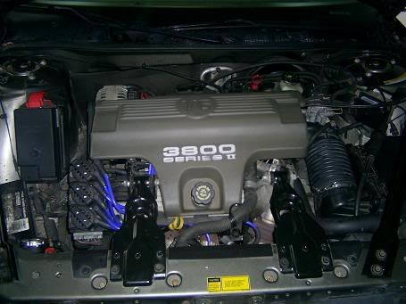

because of the age, and being we went through the same thing, im going to say you at least need wires. i just recently put another set of wires on it and new ngk iridium plugs. got some taylor spiro pro for cheaper then very good replacements, and the taylors look nice. i couldnt resisit posting it since its finally back on the road after much trouble. looks good for 145K
http://img.photobucket.com/albums/v107/federal_rider12/car/3.jpg
