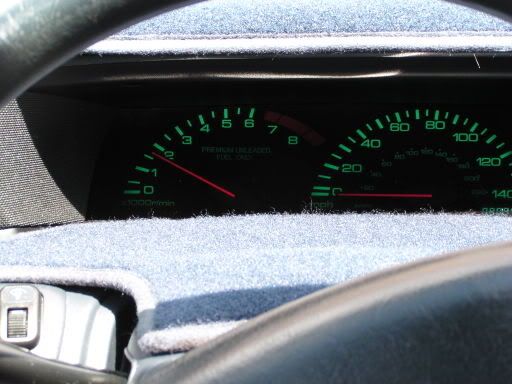

Okay, I finally got a picture of the tach. Now the cars sounds like it's at about 1000 or so, but look at the tach. This is upon cold-start.
http://i20.photobucket.com/albums/b206/mojo_stevo/Funnytach.jpg
