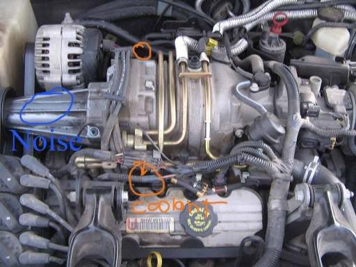

The thermostat and plastic elbow are both dry. The coolant is more towards the nose of the S/C (passanger side). It is right next to the first two fuel injectors closest to the nose.
While I was poking around, I noticed a quiet grinding noise which I isolated to the S/C nose. It is not loud but it is definately there. This would be a seperate problem though and I will search the forums on it. Oh, and the last time I changed my S/C oil was 40,000 miles ago and have topped it off every 10,000.
Although concerning, the coolant leak doesn't sound that bad. I've seen worse.
If you remove the SC belt and spin the pulley by hand it should be pretty quite. If you still hear a noise it could be the snout bearings. I've replaced mine and the snout seal.
Rule of thumb we all follow is SC oil change out annually. It is a mess doing it DIY but worth it in the long run. It will make a difference in keeping the supercharger going above 100K miles.

The coolant is just below the wire you see in the circle. Looks the same on the other side.http://i47.photobucket.com/albums/f192/normdoug/engine-illustration.jpg

I have coolant pooling in the same spot in the above picture. I cannot determine where it is leaking from and I would like to know what the problem is before taking it in to be repaired. I have a 2001 GTP with approx 107k miles. Also, I was wondering if anyone can give me any advice on what I should be fixing or normal maintenance for over 100k miles.
