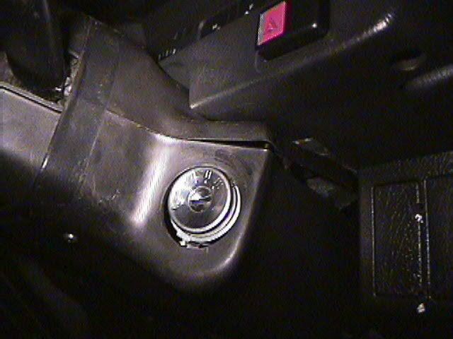

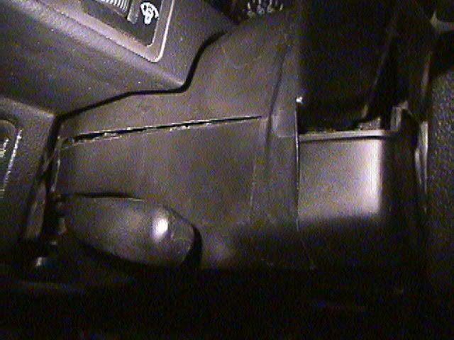

http://i32.photobucket.com/albums/d42/livinincalifornia/broke2.jpg
http://i32.photobucket.com/albums/d42/livinincalifornia/broke1.jpg
This is pepboys finnnee work...I go in to have my ignition replace the tumbler inside broke, so they tell me first they just need to replace the tumbler then "oh no we have to do the WHOLE ignition" so I say ok and authorize the purchase of a 250 dollar part and some labor that comes out to $480 total. It takes 4 days to wait for the part then they fix it in a few hours and call me to say it's ready, I go down very pleased, we do paperwork I get in the car and I literally go "W..T..F" there is black tape on my steering column and a missing cover that goes around the ignition, it looks like someone tried to hotwire it!!...I was so infuriated I started to stutter and I never stutter. I mean look at it, they tried to pass this on to me as "completed" I pride myself on having my car look great even though it has 190,000 miles and this just pissed me off..they broke it and then figured I wouldn't see the black tape. It's one thing to break it and offer to replace it, it's another to try and get it by me as "ok". I told him I want a new cover and I won't pay a cent more, not only that but I will not accept it till it look exactely how I left it and that is in perfect condition. Never again will I take my car to pepboys, and they offered to do a "fuel system cleanup" HAHHAHAHAA!! Like I want these idiots under my hood!!!

I could have done better with my eyes closed...hell, does it even start the car?
livinincalifornia
03-08-2006, 11:57 PM
barely..I have two keys now one to open the door and another to start it, not only that they didn't correctly wire it to my alarm so it doesn't recongize the key in the ignition so it was going off while I was driving!! I had to keep my door open the whole time...now that i learned how to replace the part I'm just utterly pissed, they are gonna fix it and I'm gonna get as much out of them as I can, and try to get some of my money back.

that is tape...right?...thats some shit there. thats almost like when i got new tires form tire kingdom (had stock 13's and hubcaps) they broke a hubcap and didnt say anything...well i made it over the first speedbump before it flew off...lol
long story short they paid for new ones from honda...hahah and got my "good word" out to all my friends. i hate when people do shit like that.
