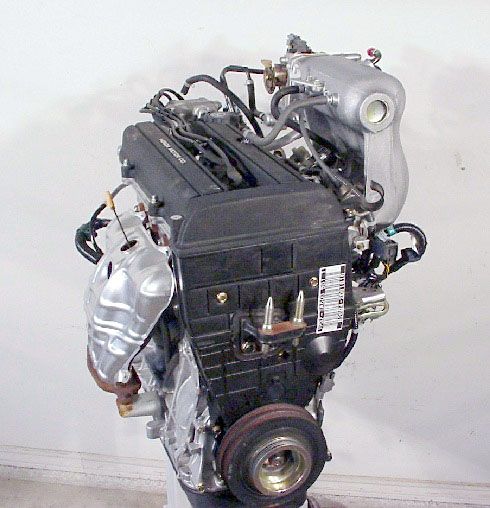

B18b
Yep.
B18B1
* 16 valve DOHC (Double OverHead Cam) engine
* PMG-FI (Programmed fuel injection) MPFI (Multi Point Fuel Injection)
* Non-VTEC
* Found in:
- 1994-2001 Integra GS/LS/RS (DC)
* Displacement: 1834 cm3 (cc)
* Compression: 9.2:1
* Power: 142 hp (106 kW) @ 6300 rpm & 127 ft·lbf (172 N·m) @ 5200 rpm
* Transmission: S80,Y80
* Redline 6800 rpm
-Quoted from Wikipedia and a few other sources
