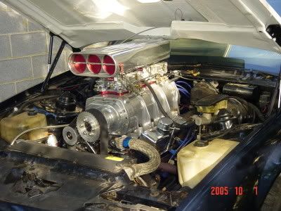

Hi, check out www.performancecncblocks.com (http://www.performancecncblocks.com) I don't know how close you are to PA, but this is the best shop around. Has a RMC V-30 cnc for block work, computerized balancer, Sunnen Diamond hone, crank grinder, also has real good prices. His prices are less than most shops charge to do work on the old (not as accurate) equipment. Heres what they built for me. http://i43.photobucket.com/albums/e391/Theresa5399/camaropics011.jpg

just curious but how far does that set-up stick out the hood, blownz2886?
