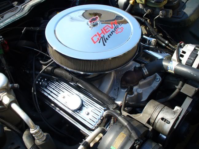

http://i26.photobucket.com/albums/c112/sgervasio/open.jpg
http://i26.photobucket.com/albums/c112/sgervasio/acl.jpg

sweet...that thing loogs good in there....as foose would say its like a diamond ring when you open the case...
