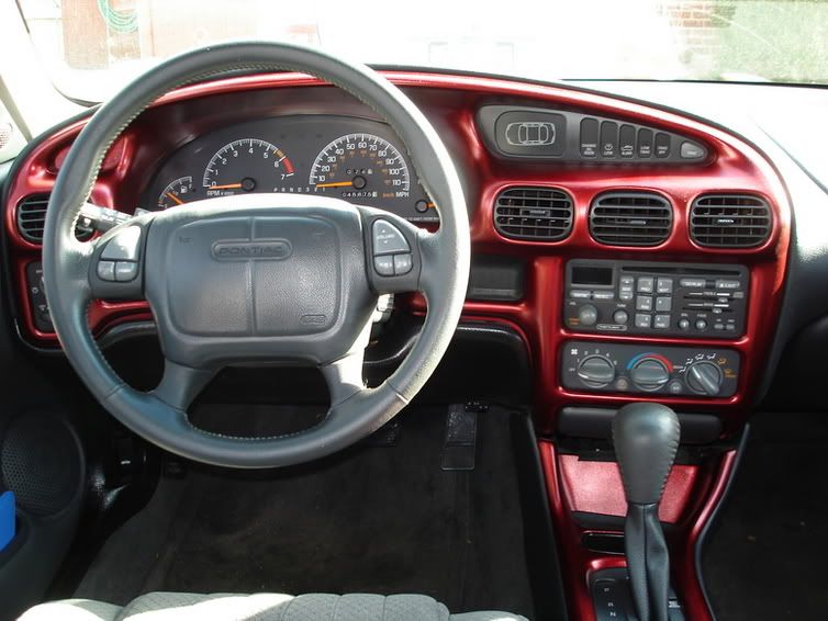

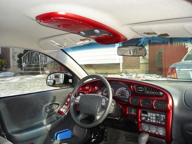

I painted all my interior trim during the fall. THe key, like everyone said, is to prep, and the best way i found to prep was to wash all the plasic parts with warm water and a light cleaner. Then, I took a light grit sandpaper, i think it was 120, and sanded each and every plastic piece of that car. It was a pain in the ass, I'll be honest, but it came out looking good. I used Duplicolor metal-flake red spray paint, gave each piece two light coats, then a final one, a little thicker, and let everything dry.
The results were great, and, i really spices up the inside of the GP.
I have a few images for you, just to get an idea:
http://i6.photobucket.com/albums/y235/JstCloseUrEyes/Chriss%20Car/4c.jpg
http://i6.photobucket.com/albums/y235/JstCloseUrEyes/Chriss%20Car/2cc.jpg
Good luck with the project.
