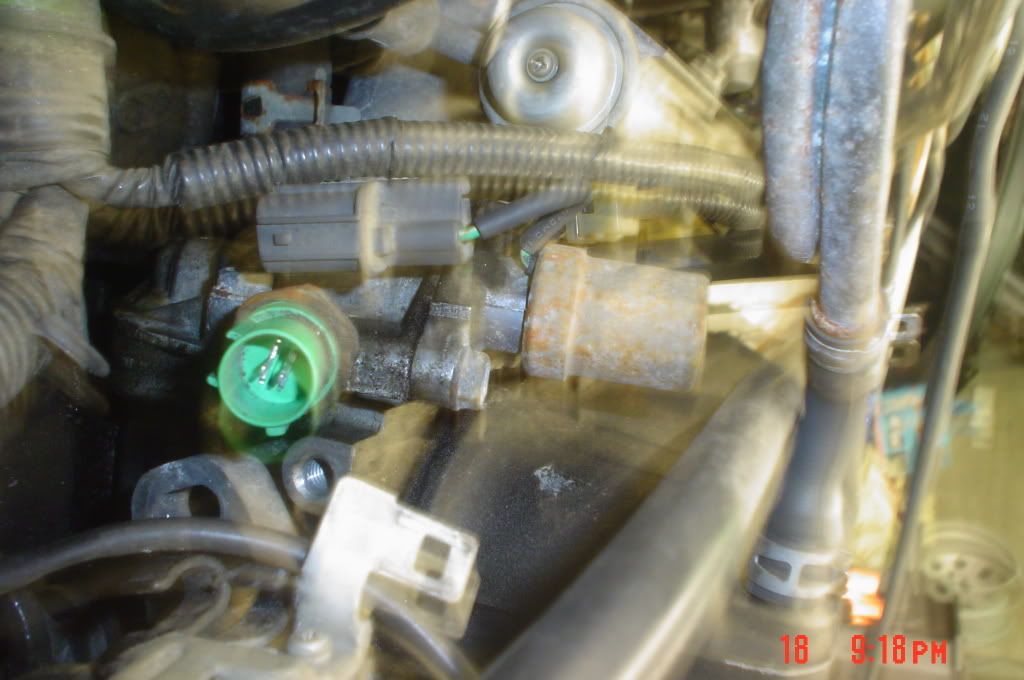

where does this vacuum hose go? (on back of intake manifold)
http://i29.photobucket.com/albums/c293/StreetLethal122/RIDES/CRX/DSC04674.jpg

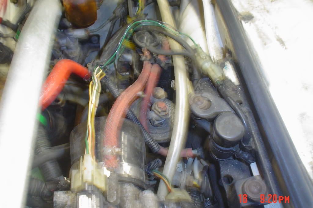

this is what i have for intake...there is map sensor on tb and one on firewall...
http://i29.photobucket.com/albums/c293/StreetLethal122/RIDES/CRX/DSC04675.jpg

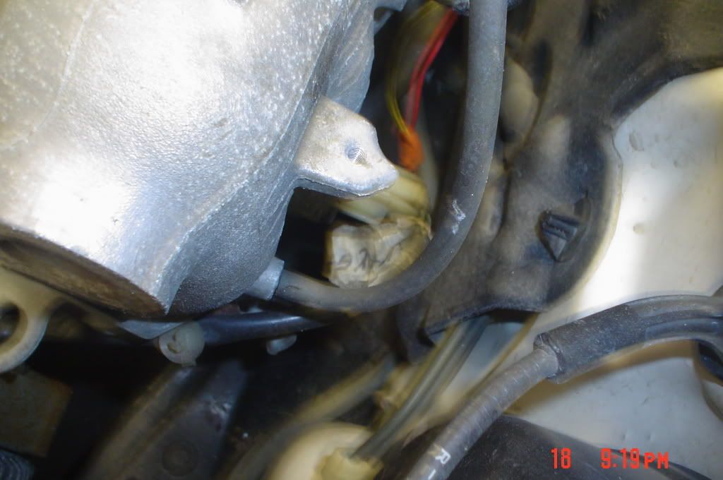

which wire do i connect to power for vtec to work?
http://i29.photobucket.com/albums/c293/StreetLethal122/RIDES/CRX/DSC04673.jpg

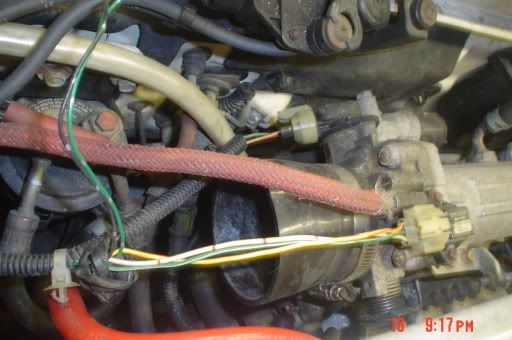

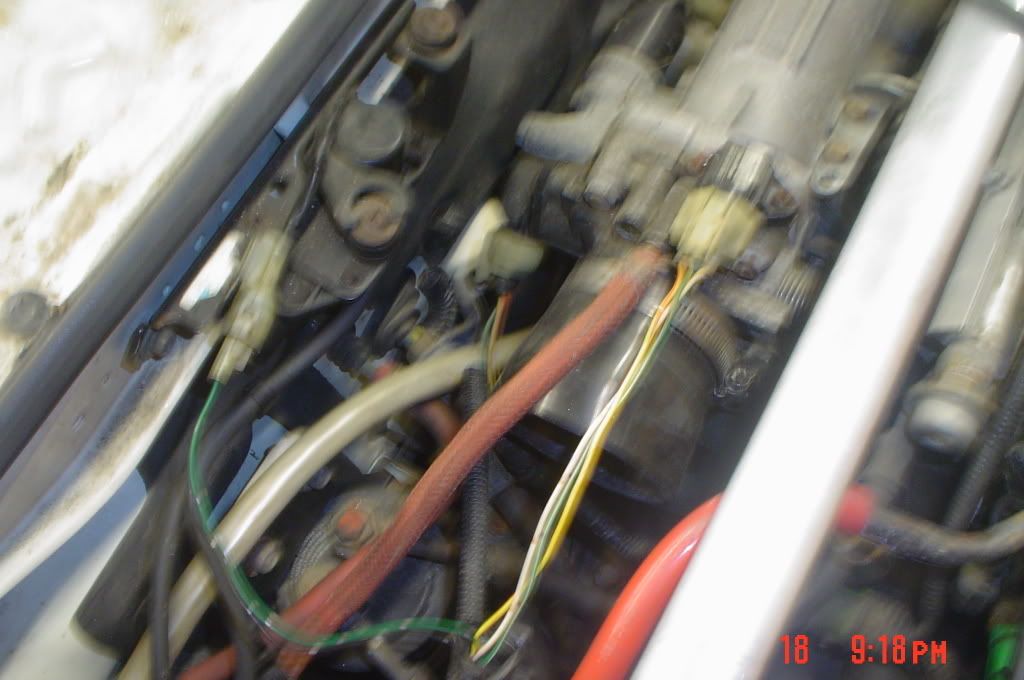

some more intake pics...
http://i29.photobucket.com/albums/c293/StreetLethal122/RIDES/CRX/DSC04671.jpg
http://i29.photobucket.com/albums/c293/StreetLethal122/RIDES/CRX/DSC04669.jpg
like i said before i didnt do this swap, and havent done this type before and im pretty much lost...thanks for yr help
