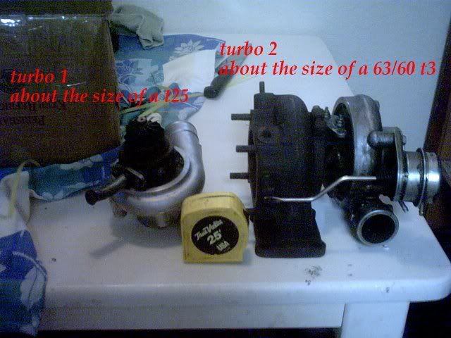

the first gen is a 14b. it is alittle bgger than a t25. i would run a 48/60 or a 63/60 t3. the second is laggier but i like it more. i decided to help you out and take a pic so you could see the difference. a 14b would be a little bigger than turbo1 and a 63/60 would be a little smaller than turbo 2 but are close enough.
http://i26.photobucket.com/albums/c114/miktorres/turbos2.jpg
and more boost doesn't mean more power. 15 psi on turbo 1 would most likely make less power than 8psi on turbo 2.
