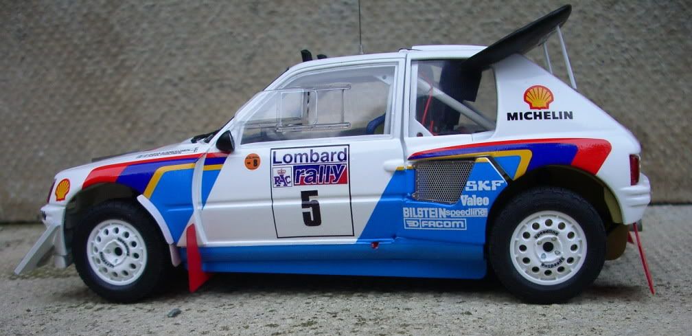

I made some decals recently for my Peugeot 205 T16 Evo 2 to convert it to Rac Rally 1986 using the inkjet paper.I ordered white and clear sheets.I found the colours worked better on the white paper,though I did use the clear for the black numbers for the doors etc and they printed really well but they were slightly transparent.If you are putting the Marlboro logos on a white background they should be ok but if they are going over colour they may be a bit see through.I found the best print was achieved by setting the printer to glossy photo paper settings (for the paper) and using the high quality setting.If you want the best it may be better to get some aftermarket decals but for the odd decal the inkjet decals are quite good.Make sure you seal them well or they just vanish when you dip them in water.Here's a pic of the peugeot.The door placard is printed on white decal paper and the number five on the clear decal paper.Steve.

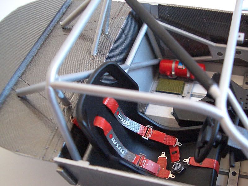

I done that with BMF: cabon pattern in the backpanel and on the doors of that skyline: sealed with a couple of thin coat of TS13

not in the chrome, in the transparent, applied over silver, also i tought with a smoke final touch could be better

I didn't use a clear varnish to seal the decals I used Microscale Liquid Decal Film.It comes in a small bottle and you can brush a few coats on the printed decal before you apply it.It dries almost instantly and leaves no brush marks.Steve.
