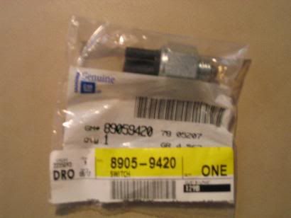

The thing under your battery is the vacuum acuator. To test it you can tap into any vacuum hose with a tee. Run a hose from the acuator to the tee in the vacuum line. This should make it draw in and pull the cable that ingages the front end. This is what turns the light on inside your cab that shows it is in 4wd. If this works you have either a problem with the vacuum lines or you have a bad actuatot switch that is on the top of your transfer case. The switch is a very common problem. I have mine replace every other year. This is what the switch looks like. The vacuum hose runs from the intake down to the switch and then up to the acuator.
http://i5.photobucket.com/albums/y196/ZR2/switch.jpg
