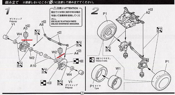

Well, i've been working on this for a while now, but i can't seem to figure out a way to lower the front. the rear rims were just right but the front is just totally out of proportion. does anyone have any tips or how you would go about lowering the front on this kit? thanks

Ok, look, try this, i think it works!
http://i41.photobucket.com/albums/e263/MyX85/10022634z.jpg
Cut off in the red line, and glue together...
This is my idea...
This is my idea...

cutting off the struts i got but im worried about part A2. from what i see, it'll be to high to glue onto the shornened strut? would i have to bend the plastic piece on the ends for it to fit the assembly?

yeah, im pretty sure if you were to lower it by cutting the strusts that you would have to bend the linkages on A2.... or cut them and glue them back at an angle so it fits... not quite sure...

well, i finally lowered the car, thanks to Myx_85's idea of cutting the struts shorter. however the A2 part i did not want to spend time cutting so i made them fit by heating and bending. here's the results:
