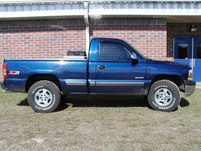

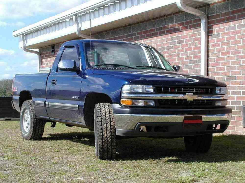

I had some of the old Coopers before they changed tread design and they rocked!!..let me find a pic for you with them.

Okay..heres the pics with the Cooper 285's
http://i14.photobucket.com/albums/a342/jceverett/Z714.jpg
http://i14.photobucket.com/albums/a342/jceverett/Z711.jpg
2500HD4x4
02-10-2006, 09:33 AM
Jeverett,
You said you loved the Coopers......How many miles did you get out of them, and what type of driving (city/highway)?

jeverett
02-10-2006, 12:24 PM
Jeverett,
Thanks!
I got about 50K out of them b/c i rotated them every 6k miles. I do mostly highway driving, with a bit of light off road.
They are quiet, and get good grip considering theyre a all terrain. I wouldn't heesitate to go with them again. Like I also said, they've changed the tread design since that set in the pics.
