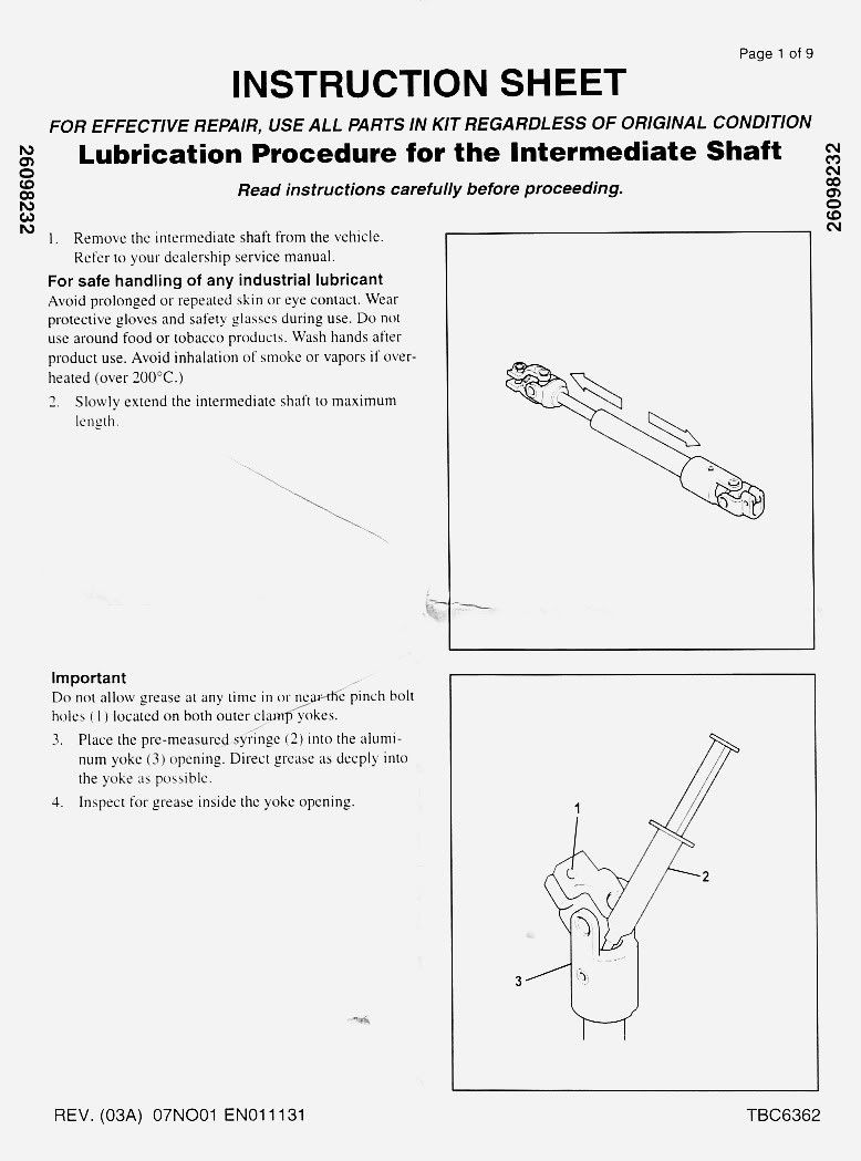

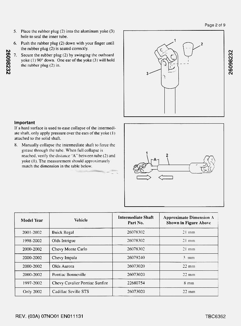

The steering shaft issue is mostly a light, soft clunking type of sound - actually will sound like it's in the column area itself - inside the car. It won't really make the steering feel loose, it's just kind of an irritating sound/feel. (My wife never even noticed it). Being a mechanic, I picked up on it right away, and after having the car for about 10 months I finally got off my ass and fixed it.
Here's the first 2 pages of the instructions for the steering shaft repair.... I didn't remove the shaft from the car totally. I just unhooked the shaft from the top and did it in the car. KEEP IN MIND, you don't want the steering wheel to move very far (left or right) once the shaft is disconnected or you will damage the spiral spring assembly for the air bag system. I used some bungee cords and secured the steering wheel to the right door somehow to keep it from moving. Also, it's a real bear getting the top of the shaft back on.
http://i5.photobucket.com/albums/y158/kmohr3/steeringshaft1.jpg
http://i5.photobucket.com/albums/y158/kmohr3/steeringshaft2.jpg
