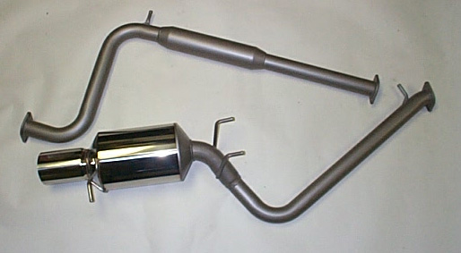

if you're looking to get a civic, there are literally tones of things you can buy for that car. it's such a popular car, plus alot of young people buy them and modifiy them that the demand is there.
The reason loud exhausts are good for performance is because they generally provide better exhaust flow. a muffler has all kinds of walls and bafflers to deaden the sound, but it also creates backpressure that prevents the exhaust from flowing at high speeds. a bigger, less restrictive exhaust with a straight through muffler will allow more exhaust to flow at a higher speed. however, just adding a muffler will give you little or no performance gains (as in under 1hp) because it's generally the exhaust piping that is restricting flow. curtis73 posted some good info a few pages back about intake and exhaust flow. ill just summarize what i got out of it since i haven't found it (or rather i haven't looked for it). there's no point in increasing the flow characteristict of one particular part if it's not the most restrictive part in the system. your intake or exhaust system can only flow as much as the most restrictive part. so if you have heads that flow 250cfm and an intake that flows 150cfm, there's no point in getting higher flow heads because it won't give you more power, you should upgrade your intake piping, get less bends and a polished pipe (polished inside becaus that won't restrict flow as much). then once you upgrade that to one that will flow 500cfm, you upgrade the next most restrictive thing. the same goes for exhaust, if your muffler allows more gases to get out than your piping, there's no point in replacing it untill you need to.
The hard part comes in determining the most restrictive part. when you're upgrading, you should upgrade everything, so if you're going to get a better intake, upgrade your throttle body, intake plumbing, intake manifold, and heads. if your wallet doesn't allow that, upgrade what seems right first, so get a cold air intake, then a throttle body, then some new intake runners (or manifold). one thing you'll notice is that you will see bigger power gains the more you upgrade, so adding a new intake will get you maybe 3-5hp. if you get a bigger throttle body first, then the intake might get you maybe 5-7hp.

http://www.roadraceengineering.com/3g/parts/greddy/v6-greddyexhaust-parts.jpg
What is the intake referring to? Also if you can, i will really appreciate if you briefly explain ' remove unwanted rotating mass, lighten things, better oil, advance timing, etc '. You mentioned 'foced induction' which from googling, i found to be a bit too much for me personally. Also, wouldnt it effect the fuel economy? more fuel being mixed with air meaning more fuel it needs? Correct? If you can, will you please elaborate on your last paragraph? Im googling the terms as i write this post but i cant get information on some of them. From your last paragraph, i know now about 'forced induction', 'super charger system', 'turbo charger system' and ' Alcohol injection' ( http://www.rjcracing.com/SMC_Alcohol_Injection/smc_alcohol_injection.html ).
