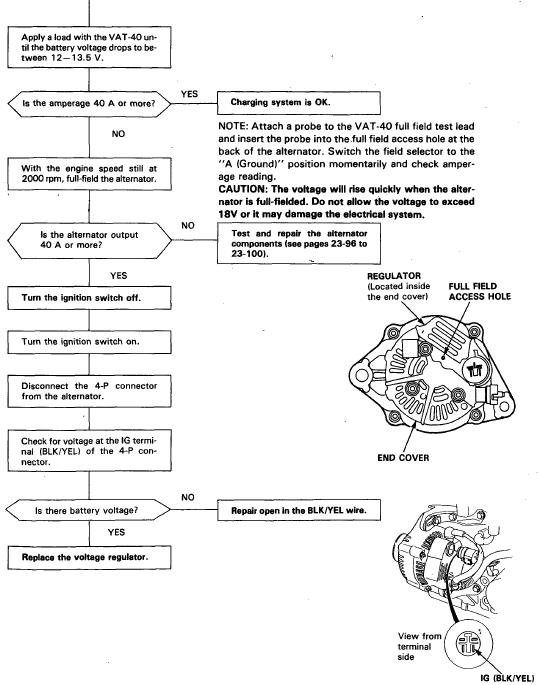

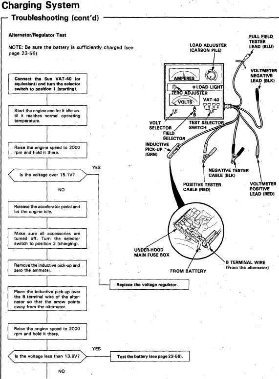

Just wondering how I would go about testing the voltage regulator on my alternator? I have it removed from the alternator, so i was wondering if I could use a multi-meter or somehthing to make sure its good.

http://img.photobucket.com/albums/v473/CivicSpoon/93tegalt.gif
http://img.photobucket.com/albums/v473/CivicSpoon/93tegalt2.gif
Don't know if it will help, but I hope it does.
Edit: that was messed up, should be fixed now.
kcg795
01-10-2006, 11:46 PM
You need a microscope to read those. That definently won't help this guy.
lkailburn
01-16-2006, 11:15 PM
view the image fullsize, not scaled to fit IE and you can read them fine
CivicSpoon
01-16-2006, 11:26 PM
It was actually my fault, some how when I uploaded the files, they were tiny. I believe it was the size of the file (too many mb's), and photobucket resized it. But I shrunk the size down by saving them as jpgs, and they work now.
