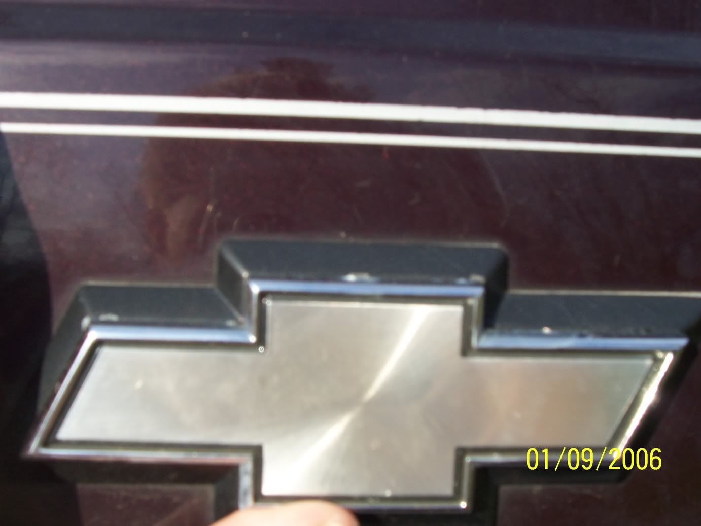

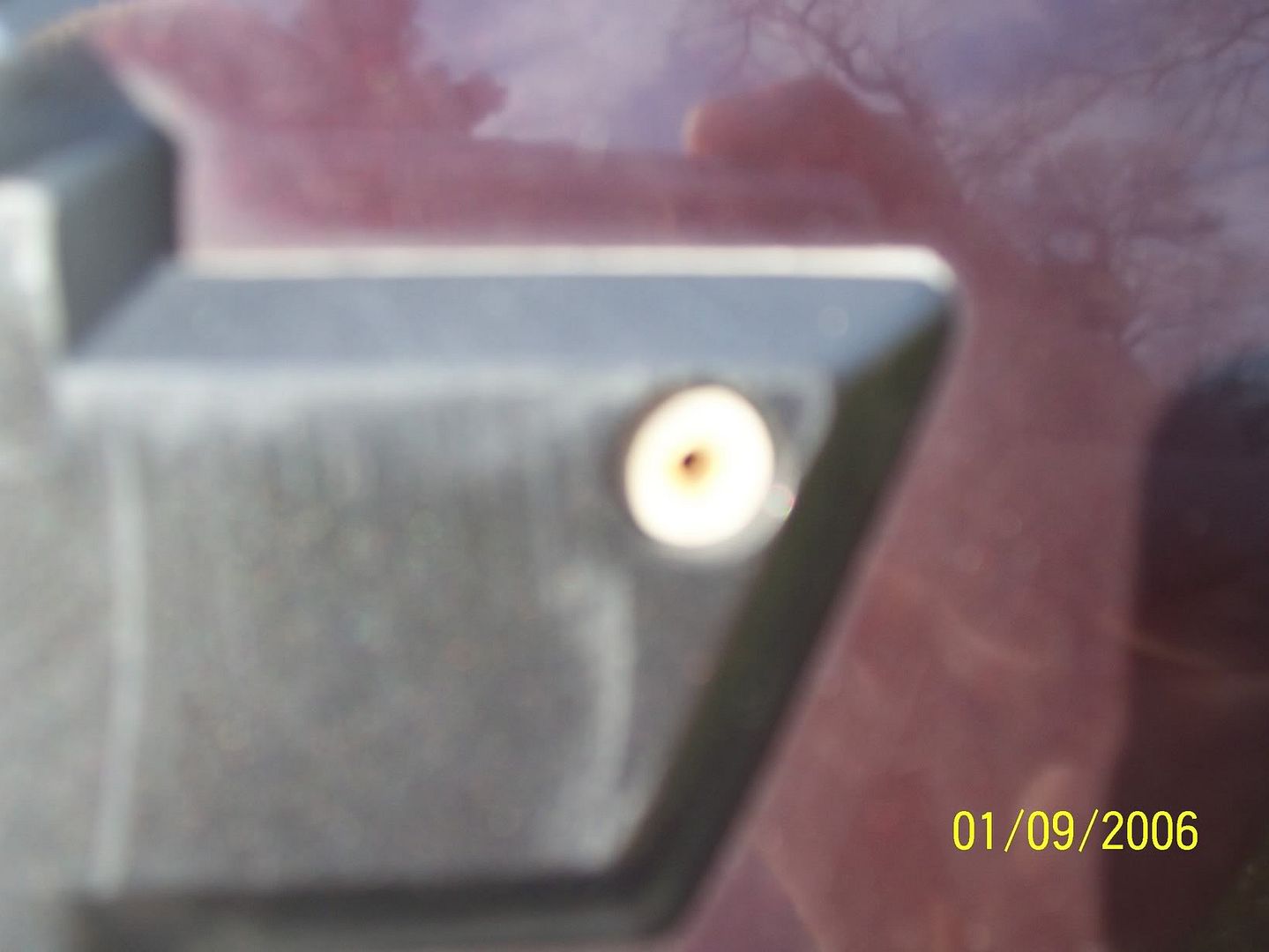

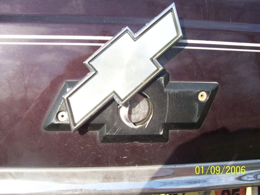

maybe these will help..
http://i46.photobucket.com/albums/f124/jrock4570/100_1173.jpg
http://i46.photobucket.com/albums/f124/jrock4570/100_1171.jpg
http://i46.photobucket.com/albums/f124/jrock4570/100_1172.jpg
1986Z28
01-11-2006, 02:33 PM
uhhhh drill them out i cann see the rivets, take a bit around 3/16 i think it was and drill em, thats all you do the rivet head falls off and the emblem comes off that easy
