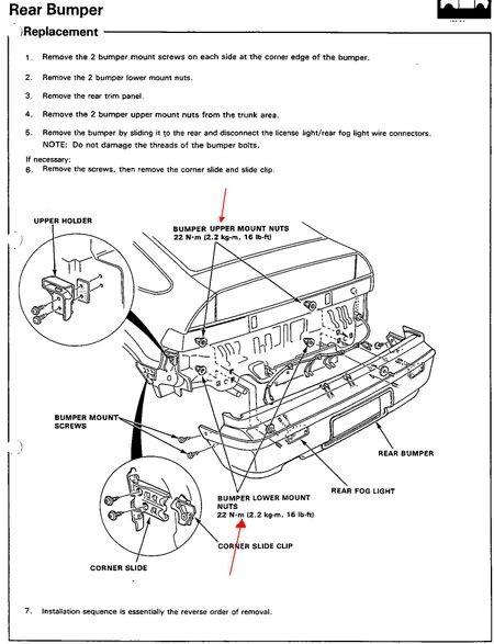

I just bought a 89 civic 4 speed for 720 dollars. The body needs some help but i think i am not going to do much but keep it clean. The car had gotten hit in the rear. How do i take off the rear bumper assembly to see the damage? Were are the bolts at? I found the bolts in the fender area but i cant find where the others are. Please help.

Think your forgeting the ones which you loosen from inside. 4 x 10mm bolts. Need a deep socket or extension. by doing this though you will be removing rear bumper & bumper cover. eaiser this way. For Rex but same for hatch.
http://i15.photobucket.com/albums/a353/H4thgenFreak/bd1400c5.jpg
GL
