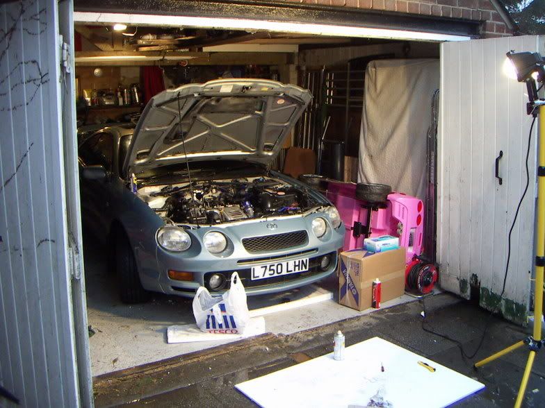

My poor car as it is today
http://img.photobucket.com/albums/v472/nialusa/Carrepairs12.jpg
I think it will be there for a while.

I have that same light lol
I was quite suprized how much heat it gives off....it was very cold today, but i was toasty warm from the heat from the light.....made working on the car alot easier.

i like your pink corvette :)

yea whats that vette run? :D

Well, the Vette is my daily driver for a while now, zero to top speed in about 2 seconds...three gears including reverse. working pop up head lights, 1 mile to a charge, radio, light weight, dosnt need petrol.....ever. 2 seater, convertable. Only problem is the lack of boot space and the flowers on the hood :?....currently faster than my GT4.
