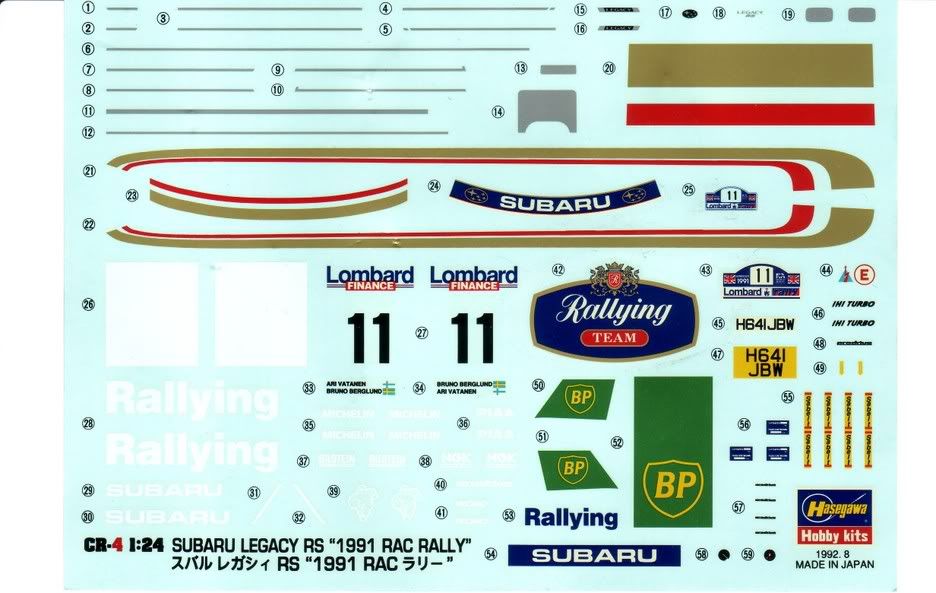

Here is a scan of the Rothmans decal sheet.Save it to your computer and print it out.You can use the scan as a pattern to produce the stripes from decal sheet or as a pattern to make masks for painting the gold.If you look on most hobby sites you can get a sheet of gold decal paper.If the size is wrong (sometimes the images get resized at photobucket) let me know and I will E mail you the scan.

Just printed the scan out on my printer and it is slightly on the large side.You could try reducing it on your printer.The number 1's that make up the 11 on the door number board are exactly 11mm high on the decal sheet.If you adjust the size on your printer till the 1's are 11mm high it follows that the whole print will be the correct 1/24th for your model.Hope this makes sense?

Thanks Steve. What a dude.....This is going to save me so much time and hassle.
No excuses for not starting my next project now then I guess.

The decal sheet saved from the forum comes out at around 79mm wide and 300 dpi in Photoshop on my pc.
If it's not too much trouble and there's no rush could you e-mail me a copy direct scanned at 300dpi, full size and then let me know the width of the whole decal sheet (Just the blue decal area on the scan) that would be a superb help.
Oh one last thing do you know what the thin silver stripes on the top left of the sheet are. Are they window/door trims?
