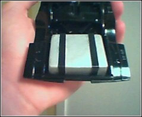

I do mine from styrene card.
1. Remove the original fuel tank
2. Measure the opening
3. Cut a square/rectangle large enough to overlap the opening on all sides so that it "hangs" from the chassis.
4. Hold it in place, then mark the opening so that you have a square/rectangle the same size as the opening on the base peice. Then decide how low you want it to hang from the chassis. As well as what shape you want it to have (square, slanted, etc)
5. Now cut the sides and bottom and glue them all together.
6. Attatch the "box" you just made to the larger piece that will hang it from the chassis.
7. Finally drop it in from the top side of the chassis plate.
8. You can add some straps if you'd like.
Hanging from the chassis:

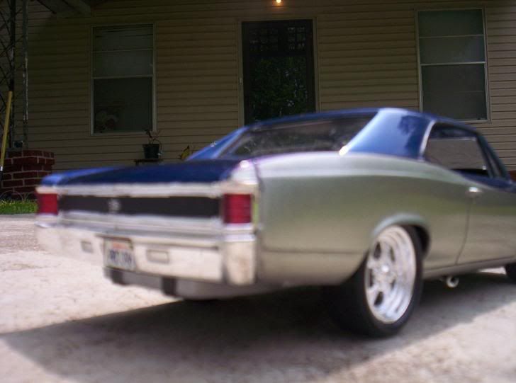

Peeking out from under the rear bumper:
http://i12.photobucket.com/albums/a218/black2002ls/miscellaneous/100_0193.jpg
