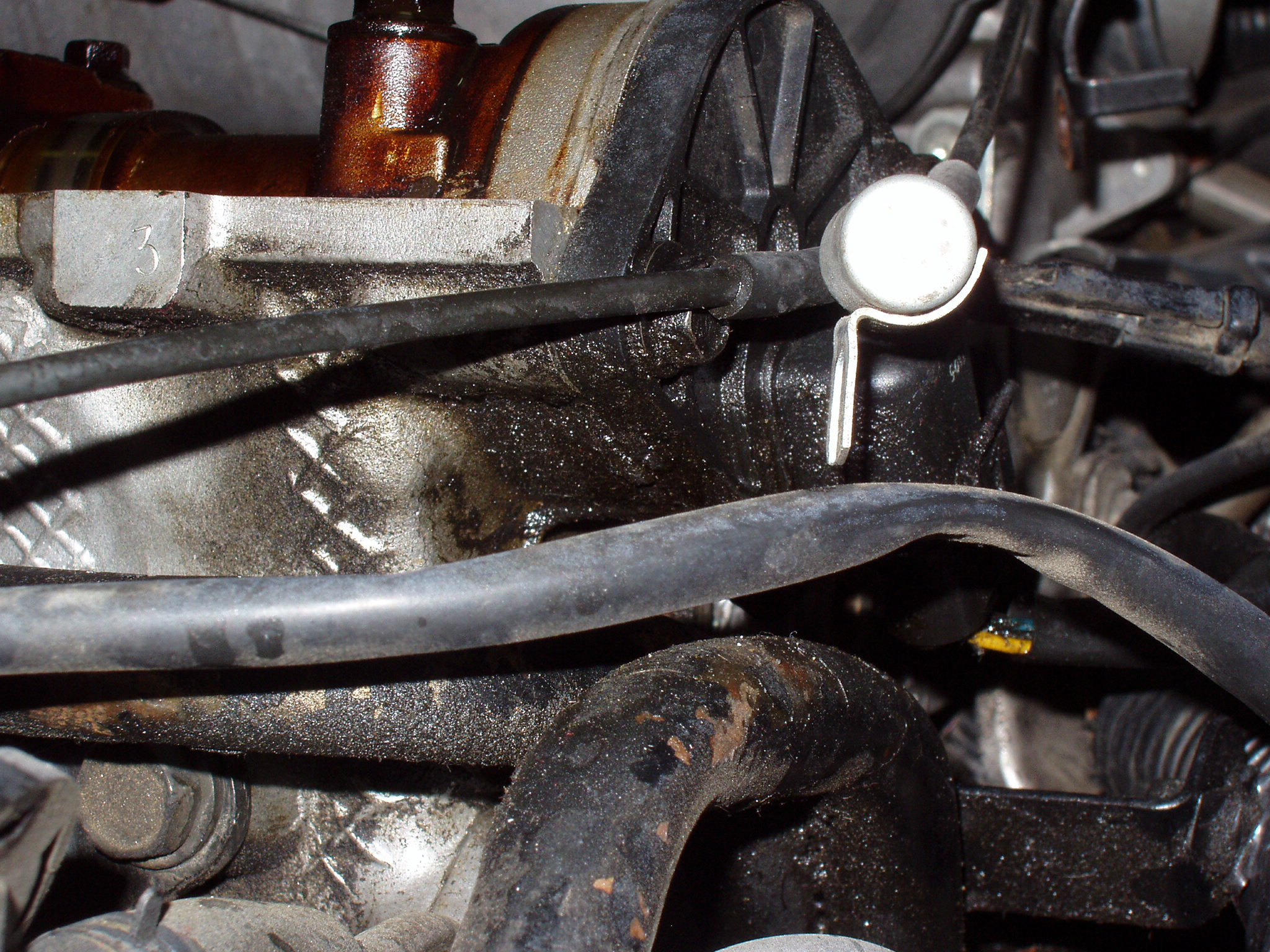

I'd like to remove it to find out if it's leaking too.
Is it timing/position sensitive or can I just remove it and look for a leak?
http://www.dotp.com/eclipse1995/PC220013.jpg

It would also help if you told us what car we are looking at, but from the picture I have no idea.

The sensor with wires running to it under the little silver can apears to be a camshaft position sensor.
They usually have a o ring seal on them leak or can leak threw the wiring plug.
You will need to test for leaks with engine running.
But I am just guessing without year make and model and eng and trans and mileage and how many doors.
Like what has been asked what is it?
MT

The car is a '95 Eclipse GS with a non turbo engine.
Camshaft position sensor sounds right since it is attached to the end of the camshaft.
As you can see from the picture there is quite a bit of oil accumulated there, and I can't tell if it was all dripping from the valve cover, or if the sensor assembly is leaking too.
The question is, before I remove it, or reinstall, it do I have to worry about camshaft position?

I don't think so. There should be a little piece that connects inside that only fits on one way. Never taken mine off, but i think it's like that.
That little silver piece, I have no idea what that is. Been looking into that, just haven't found that yet.

Don't worry about the silver thingy. It's a suppression capacitor, it 's bolted at the front right side of the valve cover.
I'll clean it real good like and see if there is still a leak after the valve cover gasket is replaced.
