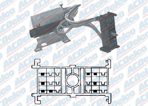

Iginiton switch assembly is always a possibility.
I am not sure about pre 1997 GPs but when an ignition switch and harness assembly is changed out it does not affect the Passkey theft deterrent system. The key tumbler/barrel is actually a separate part. The ignition switch has a module that interfaces with the tumbler. The module is the part that has the electrical contacts, cams and springs.
Hope the info helps.
Here is a pic of your ignition switch assembly:
http://i5.photobucket.com/albums/y186/lizzywiz/ignold.jpg
