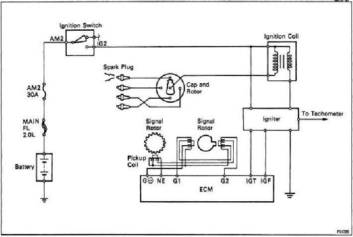

my 94 camry doesnt have spark and a fuse keeps blowing the fuse is an am2 i checked the plugs and they were fine the fuse is under the hood can someone please help

From the above diagram, it appears that you probably have a short somewhere between the ignition switch and the igniter.
Check the wiring from the ignition switch to the coil. Disconnect the coil from the ignition switch, igniter and the distributor. Replace the fuse, and turn on the ignition. If the fuse blows, there is a short in the wiring to the coil from the ignition switch. If the fuse doesn't blow, connect the coil to the ignition switch and see if the fuse blows. If it does this time, the short is internal in the coil. If not, connect the coil to the igniter and disconnect all other connections to the igniter. Try again. If the fuse blows, then it is the wiring to the igniter or an internal short in the igniter.
If nothing happens to kill the fuse up to this point, post with your results and we will rethink.
