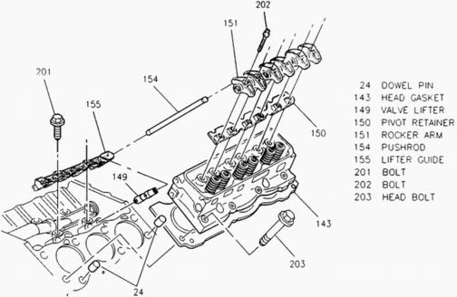

Not only an expensive project but very time consuming and tedious. Here's a breakdown of a Series II 3800 top end. I'm pointing this out because a roller rocker and the pushrod job is one thing but I believe you mentioned replacing the lifters. That will require removal of the supercharger and lower intake manifold, etc.

My next mod project is installing SLP 1.8 roller rockers and pushrods so I have been doing a lot of research on it.
