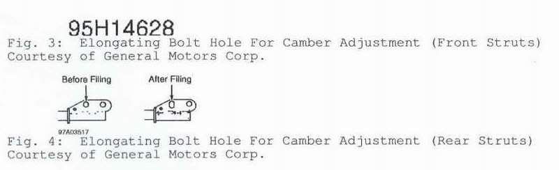

Well i took the car to town fair tire first thing this morning. They were able to align my car and said that there is no damage done. I asked if they checked the struts and they said they were good. The tire scrapeswhen it is turned to the right still. The person at townfair tire explained to me that they tried to adjust the camber. Now in order to move the wheel closer to towards the front of the car, they said i will need to enlongate the front camber adjustment. They said once i do this they will realign it again for free.
Now when i go to enlongate this hole, for the adjustment i should make it so the bolts will be closer to the front of the car right?? I hope that i can do this with a drill bit without removing the strut since i do not have spring compressors.
Does this sound about right to you guys on what i need to do? If so it doesnt seem that bad.

Thats good news, you were very lucky. Here's the procedure to elongate the strut mounting holes for getting camber adjustment. You'll need a rat tail file. Also you could get a camber adjustment bolt kit which has an eccentric bolt to replace the stock one where adjustment will be easier. GM recommends the top strut hole but you may need to do both (bottom) too. The filing must be done with the lower part of the strut removed off the steering knuckle mount.
http://i5.photobucket.com/albums/y186/lizzywiz/struthole.jpg

Thanks man! The car is driveable as long as the wheel isnt turned all the way to the right you wont hear a noise! But i want it to be how it is suppose to be. The guy at townfair tire was talking about just enlongating the holes for the bolts underneath the hood in the engine compartment where there is a cover shown in that picture i linked.
Do i need to enlongate both or just the one you told me to at the strut assembly. Will i need to get some spring compressors for this job??

For your model GP checkout the following procedure camber adjustment:
http://www.autozone.com/servlet/UiBroker?ForwardPage=/az/cds/en_us/0900823d/80/0e/dd/64/0900823d800edd64.jsp
Only if that isn't enough then you can consider the lower strut assembly hole modifcation. But I'd go with what the shop provided first and the easiest way to get the job done.

I need to get the wheel to be closer towards the front of the car. After doing some research online and what not i was wondering if there is a caster adjustment. The car is a 95 grand prix se 3.1 L.
If there isnt, then by moving the strut assembly foward by enlongating these holes will defantely move the car foward???
There is some room in the holes where the bolts come out of currently to bring it forward. I am not sure if its enough to cure the problem. But i could not figure out how to make them shift foward to move the strut assembly, any ideas? do i need to compress the spring?
I attempted to make the holes bigger today but it looks like i am going to have to remove the strut bracket that has the bolts that go to the frame of the car so I can make all three holes bigger. How do i remove the whole strut assemply from the body to do this? I am sensing i am going to need a spring compressor. Is there any other tools i will need?
BNaylor
11-28-2005, 12:48 AM
There is no caster adjustment so that's not an option. You should be able to remove the strut assembly without a spring compressor. Just undo it at the steering knuckle after the car is jacked up sufficiently. BTW - The two lower strut bolts are torqued to 130 ft-lbs so it will be a B getting them off. You'll need to hit the bolts and nuts with WD40 first. And make sure the 3 strut tower bolts are removed.
The spring compressor may come in handy after you've modified the holes and put the strut assembly back on because you will need to relieve the upper tension at the strut tower and load bearing to make the adjustment easier. Good luck!
