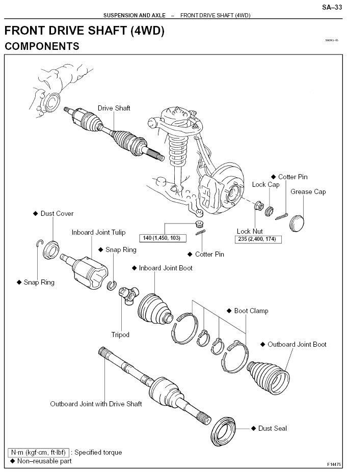

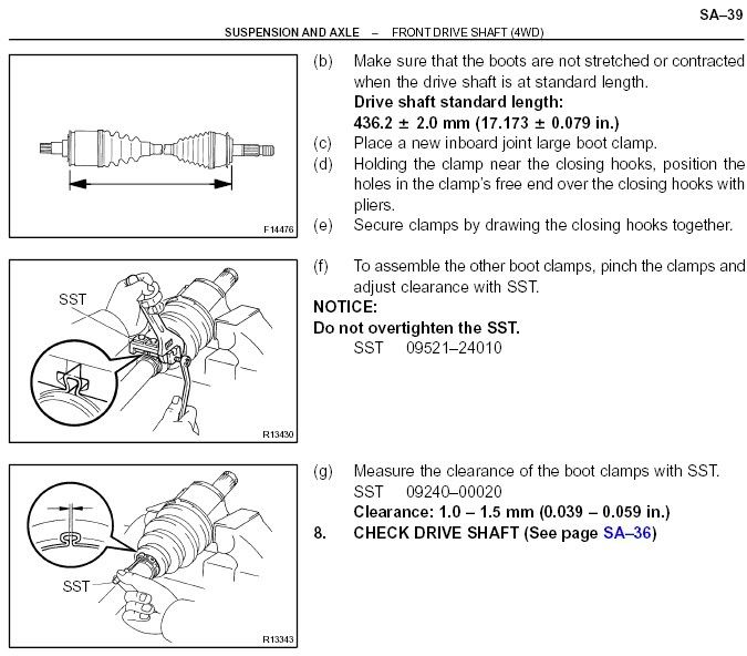

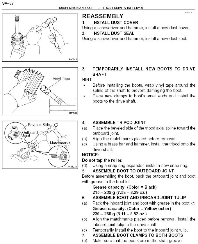

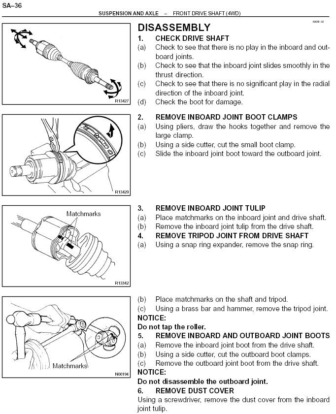

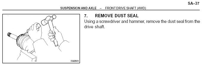

Good day Brian. No luck in getting the site to open either. I am looking for how to get the RH outer CV joint off the axle on an 03' for boot replacement. Seems like the type the you just tap off over the clip ring, but I've done a fair bit of "tapping" with no joy. Also thought it may be like a GM in which you drive the cage back out & start taking the balls out, but no luck that way either. I'm new to the Toyota section here & I will prowse this forum for some info as well. Txs
Brian R.
11-21-2005, 08:30 AM
http://i16.photobucket.com/albums/b8/rogersb/Tacoma%20Axle/TacomaAxle1.jpg
http://i16.photobucket.com/albums/b8/rogersb/Tacoma%20Axle/TacomaAxle2.jpg
http://i16.photobucket.com/albums/b8/rogersb/Tacoma%20Axle/TacomaAxle3.jpg
http://i16.photobucket.com/albums/b8/rogersb/Tacoma%20Axle/TacomaAxle4.jpg
http://i16.photobucket.com/albums/b8/rogersb/Tacoma%20Axle/TacomaAxle5.jpg
http://i16.photobucket.com/albums/b8/rogersb/Tacoma%20Axle/TacomaAxle6.jpg
http://i16.photobucket.com/albums/b8/rogersb/Tacoma%20Axle/TacomaAxle7.jpg

Txs much Brian. I guess by the look of what you sent me they don't want to take the outer joint apart, rather take the inner apart & slip the outer boot down over the axle...Tks again, Mtndw
