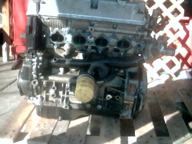

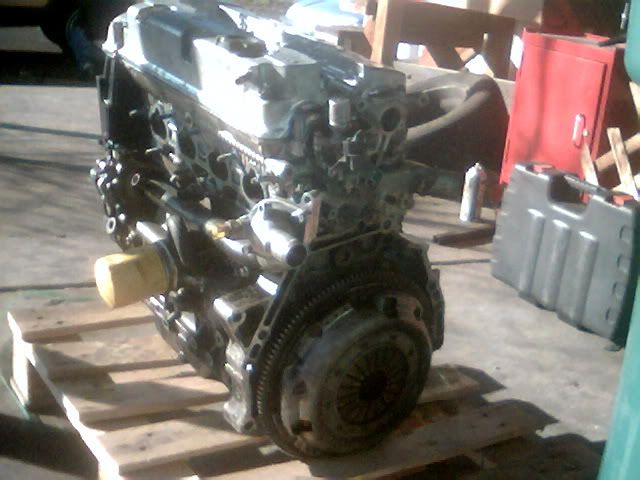

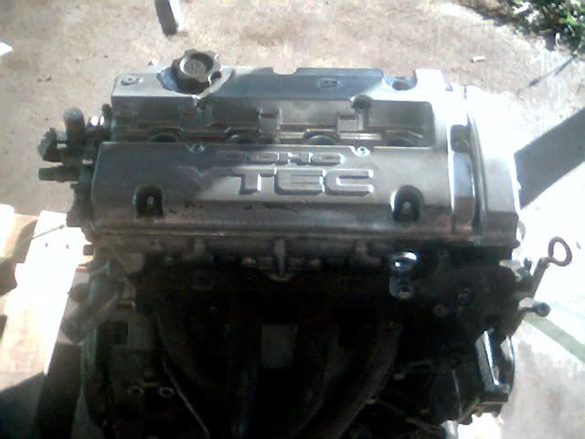

here is some pics of the motor and my car.
http://i17.photobucket.com/albums/b76/Slipknotcraig133/Photo001.jpg
http://i17.photobucket.com/albums/b76/Slipknotcraig133/Photo002.jpg
http://i17.photobucket.com/albums/b76/Slipknotcraig133/Photo005.jpg
http://i17.photobucket.com/albums/b76/Slipknotcraig133/Photo004.jpg
http://i17.photobucket.com/albums/b76/Slipknotcraig133/Photo003.jpg

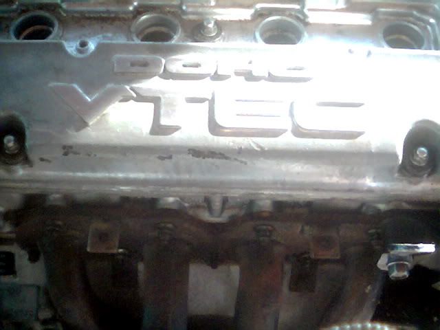

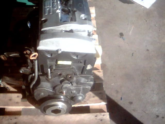

kris
11-19-2005, 06:42 PM
That motor looks beat.

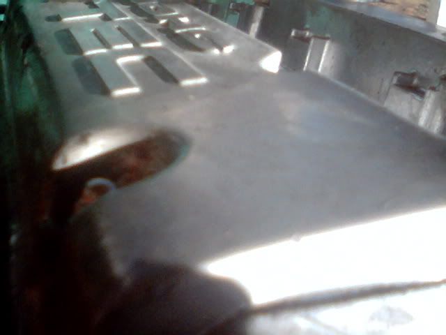

slipknotcraig133
11-19-2005, 07:08 PM
How does it look beat just because the valve cover paint is chipping. The way that i see it the motor is in good condition because on the intake side of the head the ports barly have any carbon. You can still see the bare port.
CivicSpoon
11-19-2005, 07:48 PM
Yeah that's definently not beat. I don't recall ever seeing a used engine look that clean before (other than the valve cover). You can actually see the real color of the block, and not just caked on black/brown grease covering it. Maybe it's just the pics? My camera would make it a hell of a lot worse than that (the camcorder/digital camera combos are junk, at least mine is).
doug294
11-19-2005, 08:53 PM
You can't judge a motor by the fact it looks clean. Give me 5 min and a pressure washer and it would look cleaner, doesn't mean it's good though. I would pull the motor (that way you can check for damage or anything) and replace the headgasket why it's out of the car.
BTW: I would trust Kris's eye anyday.

Going solely off those pictures, I would not buy that motor. It looks beat up to me. It's sitting there, with nothing covering any of the open holes in the head. Intake side is completly left open, not to mention the distributor hole, coolent ports, etc. Spark plug holes are wide open. (we'll assum the plugs are still in there though) The valve cover has been messed with, so that obviously means someone had it off. Why was it off, why did they paint it, what was the reasoning?
You can judge alot by the way a motor is taken care of on the outside. Granted yes, 5 mintures with a power washer can change things. But a close look at the motor will tell you if it has been power washed. When I get a car that pulls into the shop, that was a filthy engine bay, suspension areas, ect. I know its going to be a shitty job. These types of people obviously dont really take care of their cars. 9 times out of 10, their motor is thrashed the same way. Wiring is usually thrashed some how. But someone who truelly takes care of their cars, will go the extra mile when it comes to the small things. Engine bay is clean, wiring is done properly. Things are in there place.
So, you're doing all that to the block, and leaving the head untouched?
