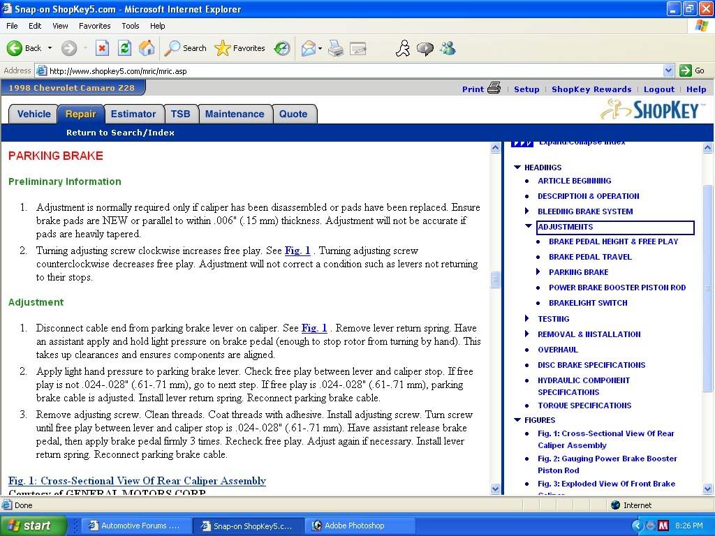

Stupid question... You're using DOT 3 correct? And brand new fluid? That has never been open for more than a few minutes while bleeding? Because water/moisture in the lines would cause the brakes to function normally until they heat up a bit, which will heat the water to steam, which expands, holding the brakes on until it cools off.
My last guess would be the parking brake adjusted improperly, or out of spec.
I'm looking at some technical service bulletins on LS1 Camaros about the brakes and stuff... something to look out for:
-When you change the pads/rotors, when you top off the master cylinder, make sure it is at the "MAX" line, because being overfilled will make the brakes act up.
I'll read up on most of the stuff and post up what I find...
flatlander757
11-17-2005, 07:34 PM
666_speed
11-17-2005, 08:07 PM
tyvm flatlander!! i knew there was a problem with the e brake for a long time...it hasnt worked in months...im going to check that out in the morning....that makes a lot of sense and i hadnt thought of it....thanks again!!
flatlander757
11-17-2005, 08:17 PM
N/p... but next time mention that the ebrake hasn't worked in months since it kinda deals with the rear brakes :wink:
